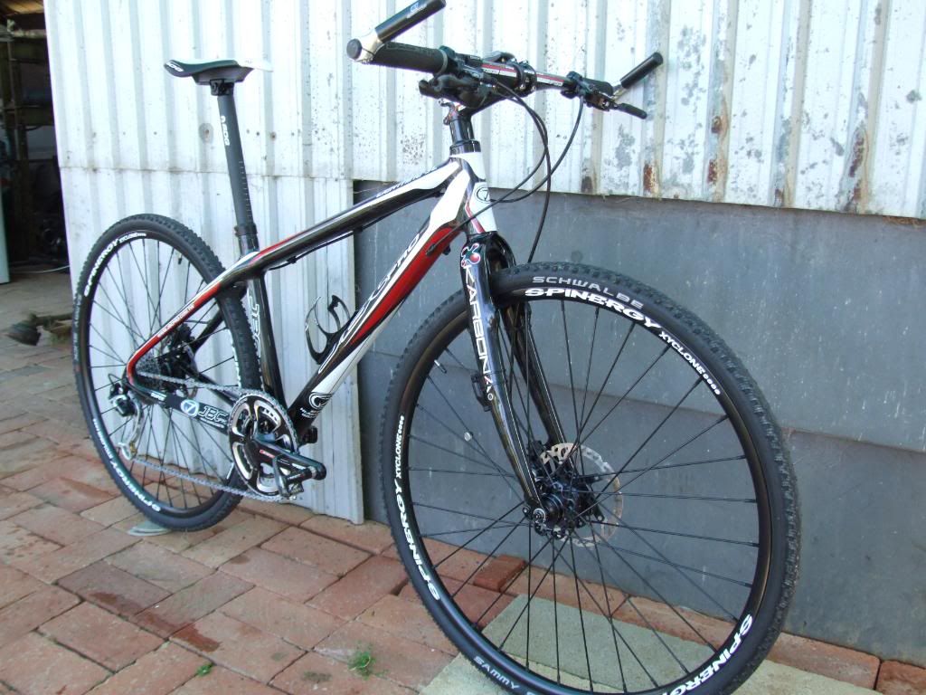

G,day I dont mean to throw to much sauce on the pie but there is another way to do it, just to confuse you :lol:
I could not buy the bike I wanted so built my own wanting a CX bike, roadbike and MTB with just a change of tyres. The pic is CX form though I think bar ends are not allowed for racing.
It has a 26er frame with 29er wheels 35c CX tyres, 50-34 compact crank with ultegra derailler "not pictured" and CX forks and is darn fast even on a day out with roadies with 23mm slicks, sure gets there attention and is a strong bike offroad.
I just wanted to show there plenty 26er carbon frames from Taiwan and they can take 29er wheels. Mine is small in size but plenty to choose from.

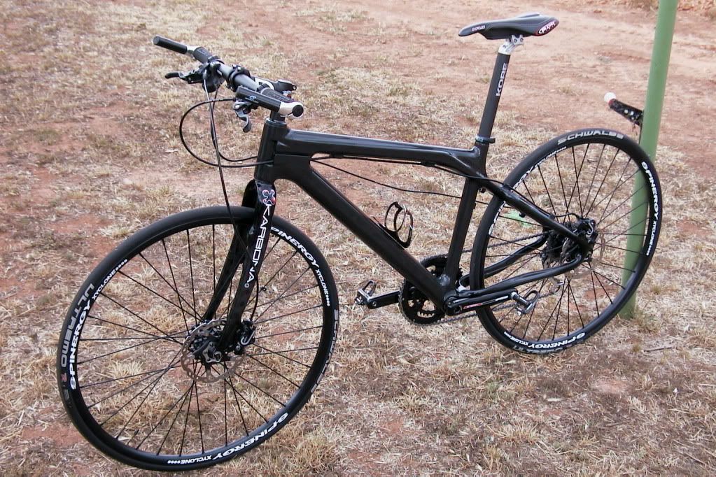

"oh" and a pic of another frame that was to big for me and now sold. Sorry if I'm confusing you more :mrgreen:

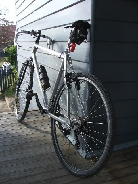

Postby drubie » Thu Oct 27, 2011 10:09 pm
Too late now for TLL, but my (now dismantled) monstercrosser - a biiiiiig 26" Norco alloy frame, but running 700c wheels and drops:
The only thing to be careful of is that the frames aren't meant to run long roadie stems, so you end up with a short stem (and resulting twitchy steering). Alloy 26" hard tails with no disk mounts were being given away at one point there...
Of course, I needed a mountain bike so I pulled all those bits off:

jbchybridrider wrote:I just wanted to show there plenty 26er carbon frames from Taiwan and they can take 29er wheels. Mine is small in size but plenty to choose from.
That looks like a nice rig!...too late now (but I will still be buying a 29er next year sometime)...what is the clearance like around the rear wheel?...around this part of the world you need a huge amount of mud clearance.

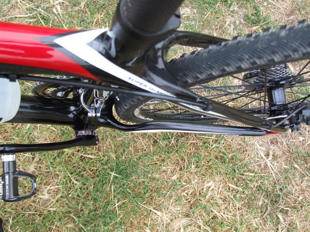

Postby jbchybridrider » Fri Oct 28, 2011 9:37 pm
That Lapierre looks a pretty spectacular start to a build so just to answer the question there's 10mm clearance at the nearest point at the side nobby's which is OK though I could go down to 32-30c for more clearance.
I guess there's pro's and con's doing it this way or proper 29er, imagine the clearance on one of those with a CX tyre and it would need it just for good speed on faster course's.
The best advantage of my way is light weight at 8.1kg it's easy to grab the top tube in the hand and lift over obstacles.
A cyclocross bike is just the correct way with no mucking around cant go wrong there.
I can fit a 40c full coverage nobby it's tight though. A pic says a thousand words.
