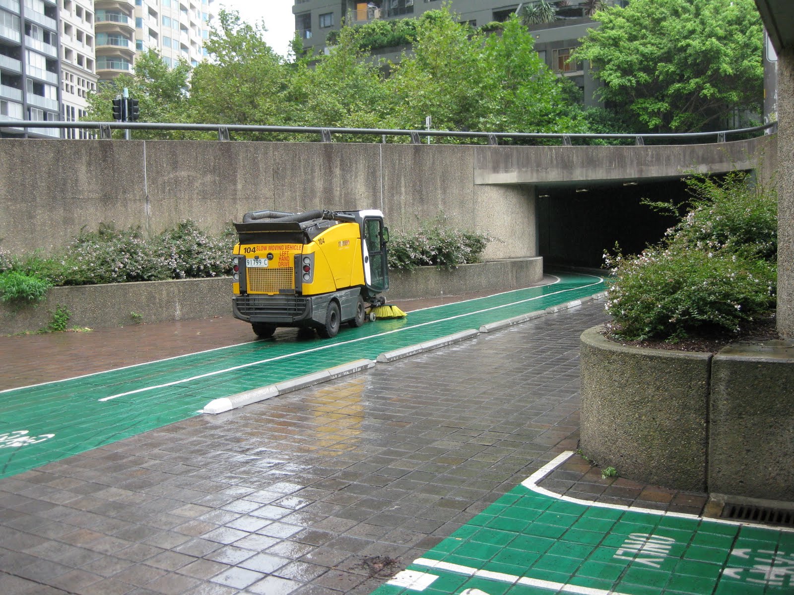

Re: Curb build outs
Posted: Tue Nov 13, 2012 5:58 pm
by il padrone
wellington_street wrote:They are good if there's a bypass (that is kept clean - streetsweepers not fitting is NOT an excuse for Councils, they are just lazy and don't care about cyclists)
Sydney street sweeper :idea:
