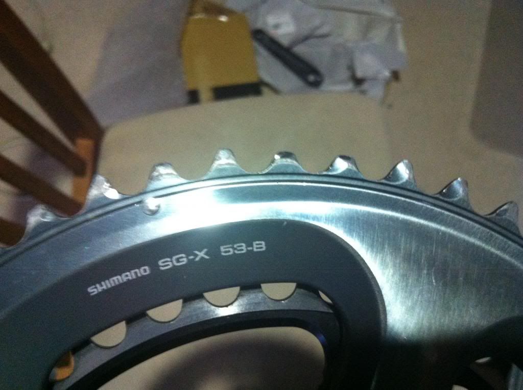

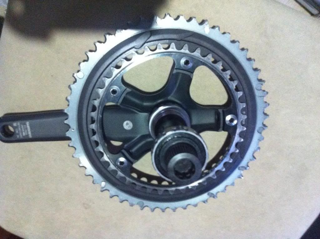

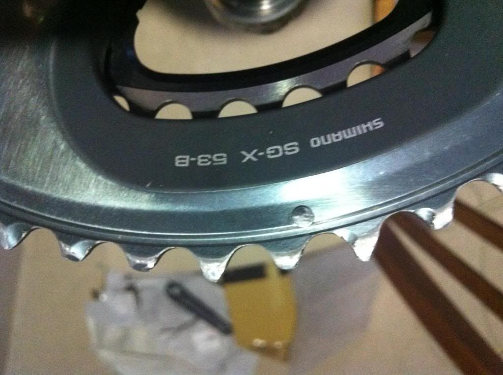

Guys just bought this Dura Ace 7900 crankset (53/39) second hand from ebay. Seller claimed excellent condition, "ridden less than 500km".
Now on the 53 ring the teeth seem to be differing lengths...is this normal or suggestive of a lot of wear?
Can anyone with a Dura Ace crank check theirs against my photos please.

Plenty of life left in them yet... they haven't done much work at all. I just threw a set away... they looked a bit different to that :lol: .

toolonglegs wrote:Plenty of life left in them yet...
+1
The teeth will resemble a shark fin where they are worn down - ie have a distinct slant on the drive side of the tooth where the chain is towed over the top of the ring.

The difference in teeth height is to aid shifting AFAIK.

Shimano teeth aren't uniform in length to aid shifting.
Bit hard to tell from your photo.
Ride it and see.

From a practical viewpoint the chainrings are not shagged until you get chain drop/pickup/jumping issues. Fit them up, re-tune the derailer and give them a hammering, you'll find out soon enough.
From the images supplied the small ring looks like it's done very little work at all. The teeth will have slightly different shapes and profiles by design with ramps and pins etc assisting to pick up and drop the chain off and onto the rings.
