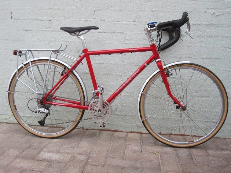

il padrone wrote:Such head-tube extensions are generally fairly non-standard frame treatments even amongst touring makers. However the Thorn Sherpa DOES have a head-tube extension.
IP - Yes, you are right of course, the Sherpa does have a HT extension but it's only about 1cm (I did say it hasn't got "much" of an extension) which in my view is insufficient for a touring bike, whereas the LHT approx 3cm HT extension is good for touring purposes in that you can get the bars sufficiently high without too many spacers.
Behind my comment is concern about the racer fashion of a large drop between the saddle and bars being inappropriately reflected to an extent on touring frames.
Greg

My Thorn Nomad has virtually no head-tube extension. But it does have a sloping top tube, which places the top of the head tube a good 5-8cm higher than the head tube on my old Giant Sedona. Result - the bars are just a bit higher than I used to have, so the same result as head tube extension*.
In other words, you always need to look at the total package and place the key measuring points in context.
Hint - to really take the load off your wrists, consider using North Road bars.
* Some prefer the appearance of a horizontal top-tube; I really dislike the look of the extended head-tube. Aesthetics of course :wink: .

il padrone wrote:My Thorn Nomad has virtually no head-tube extension. But it does have a sloping top tube, which places the top of the head tube a good 5-8cm higher than the head tube on my old Giant Sedona. Result - the bars are just a bit higher than I used to have, so the same result as head tube extension*...
IP - I understand your point. My wife's Thorn 'Sherpa' has a mildly sloping top tube & (as mentioned) a 1cm HT extension and still she needed 7cm of spacers to get the drop bars about level with the saddle. I exhaustively considered the key measuring points, by setting up the front of the bike as best I could and testing my wife's position by sitting her on it, as well as taking into account the settings of her other bikes, before the steerer tube was cut and the headset was installed in combination with the stem, spacers and bars.
This is the bike, by the way, which is used for credit card touring. I think that the aesthetics would be improved by more HT extension. This is the smallest size Sherpa (all sizes have 26" wheels) - the only one that gives sufficient standover height.
