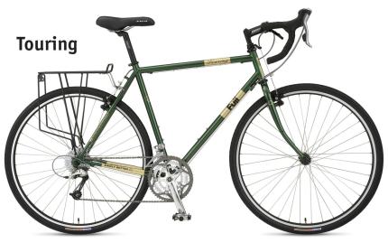

Why not just go a touring bike? 30% off 2009 Fuji roadbikes at Goldcross stores at the moment = ~$980 for the 'Tourer'..... :roll:

Postby Mulger bill » Wed Mar 18, 2009 12:34 am
Ummm, OP is looking at a tourer Kuka. First post mentioned a Salsa and a Surly.

Postby kukamunga » Wed Mar 18, 2009 8:42 am
Yeh...ok. I guess it's a tourer.....
I was thinking more along these traditional lines v ^
Salsa website wrote:Run pavement friendly 700c x 35mm rubber, or throw on some big 29 x 2.4" meat
I really can't see there being any problem in getting 700 x 35 or 40C rubber anywhere in the world. Is this the major concern? I've lost track..... :roll:
