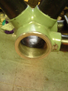

I'm in the middle of restoring my dad's old Malvern Star 10 speed and have run into some trouble sourcing a bottom bracket.
When stripping the bike back, I didn't realise that Malvern Star bottom brackets were very specific and you can't just put a new BB in.
Because it was in terrible condition, i stupidly through out the BB and am now chasing a new one.
My problem is, I do not know enough info about the bike to begin my search.
I was hoping i could post a pic of the bike and a Malvern Star expert out there could tell me the year and model and perhaps even point me in the right direction of where to source this BB from.
Your help is really appreciated!

No it's different as the one I need is threaded.
Thanks anyway though.

Well one of the cups is still attached as I did not get it off.
Of the two cups (on the sides), one has one "notch" and the other has 3.
Does that sounds familiar with yours?
I have the one with one notch still on the bike.

Postby poli84 » Sun Jul 12, 2009 1:49 am
This is where the Malvern Star resto has haltered...

If you can't get the drive side BB cup off, remember that it is reverse threaded. Another trick is to put a bolt which fits reasonably neatly through the spindle hole in the fixed cup and install the nut on the outside. Tighten the nut against the fixed cup, then continue putting pressure on the nut in the tightening direction which MAY work the fixed cup loose. A lot of pressure will likely be required. Once off, any standard british thread bottom bracket should fit.
Or altenately, take the bike to your LBS and they'll remove the cup for you.

allright, was able to take the whole thing out, took me a little while to realise it slides out :roll:
this what you need mate? Wont come with the ball bearings, but if its what you need, pm me.

Ah that is exactly what I need!
You are a life saver!
PM sent mate.
