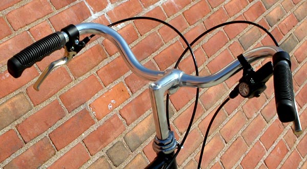

Buy yourself a set of Nitto "North Road" handlebars. This will allow you to sit straight up and takes practically all of the weight off your arms and shoulders. You may need a broader saddle at the same time. You can transfer all of your MTB brake levers and shifters straight onto these bars and they will work perfectly.
http://harriscyclery.net/product/nitto-north-road-handlebar-411.htm
Mine are not Nitto, but I thoroughly enjoy them - I used them for the 2009 Sydney-Gong ride. Not a single problem with soreness, numbness or stiffness anywhere. They are so comfortable, I would dare to say that they practically eliminate the "need" for different hand positions. By the way - I'd riding an old MTB from the late 1980's/early 1990's which is now enjoying a new lease of life as my all-rounder.
