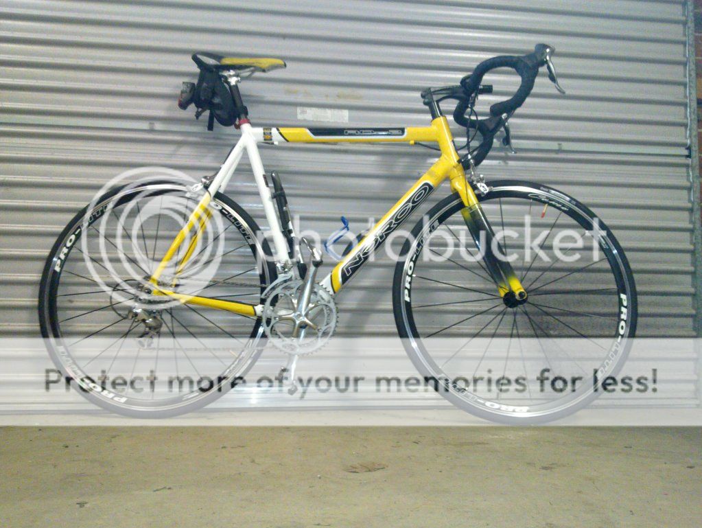

Postby macca33 » Fri Oct 26, 2012 6:28 am
Following some of the feedback off this forum, I purchased a set of Pro-lite Comos. I had my LBS fit a new cassette and I fitted the wheels last night - cannot wait to get out for a pedal today!
When I bought the bike (used) it had a set of Shimano WH-R550 fitted, but I just couldn't get over the 16f / 20r spoke count - always had me concerned as I am a statuesque sort of a bloke! Hopefully these Comos live up to expectations!
BTW - the bike, with cage / pump / saddle bag weighed in at 9.9kg with the Shimano rims on and is now at 10.2kg with the Comos - so not too bad.

Postby jasonc » Fri Oct 26, 2012 7:13 am
macca33 wrote:Following some of the feedback off this forum, I purchased a set of Pro-lite Comos. I had my LBS fit a new cassette and I fitted the wheels last night - cannot wait to get out for a pedal today!
good choice - my como's cop a pounding and still going strong after over 6000kms

Postby macca33 » Sat Oct 27, 2012 11:51 am
Well, happy to report that the first ride on the Comos was nice and smooth and they roll very well.
