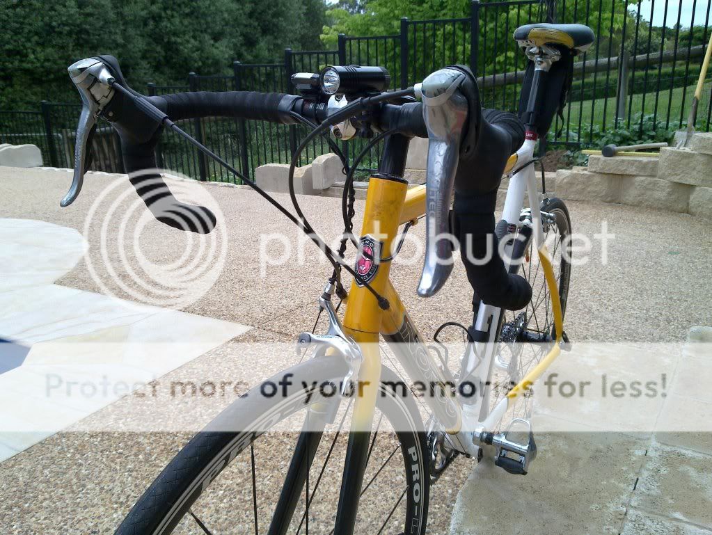

The previous owner replaced the chain / cassette front chainrings (39/52T), cables / outers around a year ago and I recently put a new cassette on when I purchased the Pro-Lite Comos. So, the F & R derailleurs, bottom bracket, crankset, brakes and brifters are still original, but apart from the brifters - which have a fair bit of wear - everything else works perfectly. The bike itself is fantastic and rides really well, so I won't be looking to upgrade for a long time (if ever) and the thought of keeping the original series Ultegra for as long as I can is appealing.
A few pics for rkelsen (I know that I've broken every Velominati rule there is, but I'm 'different' lol):-
Thanks to all for your responses. I'm still a little undecided and Ratts' info about compatibility with Ultegra 10-speed is also interesting to know, but zero may have convinced me to stay with the Ultegra 9-speed and go for the NOS levers I've found.
