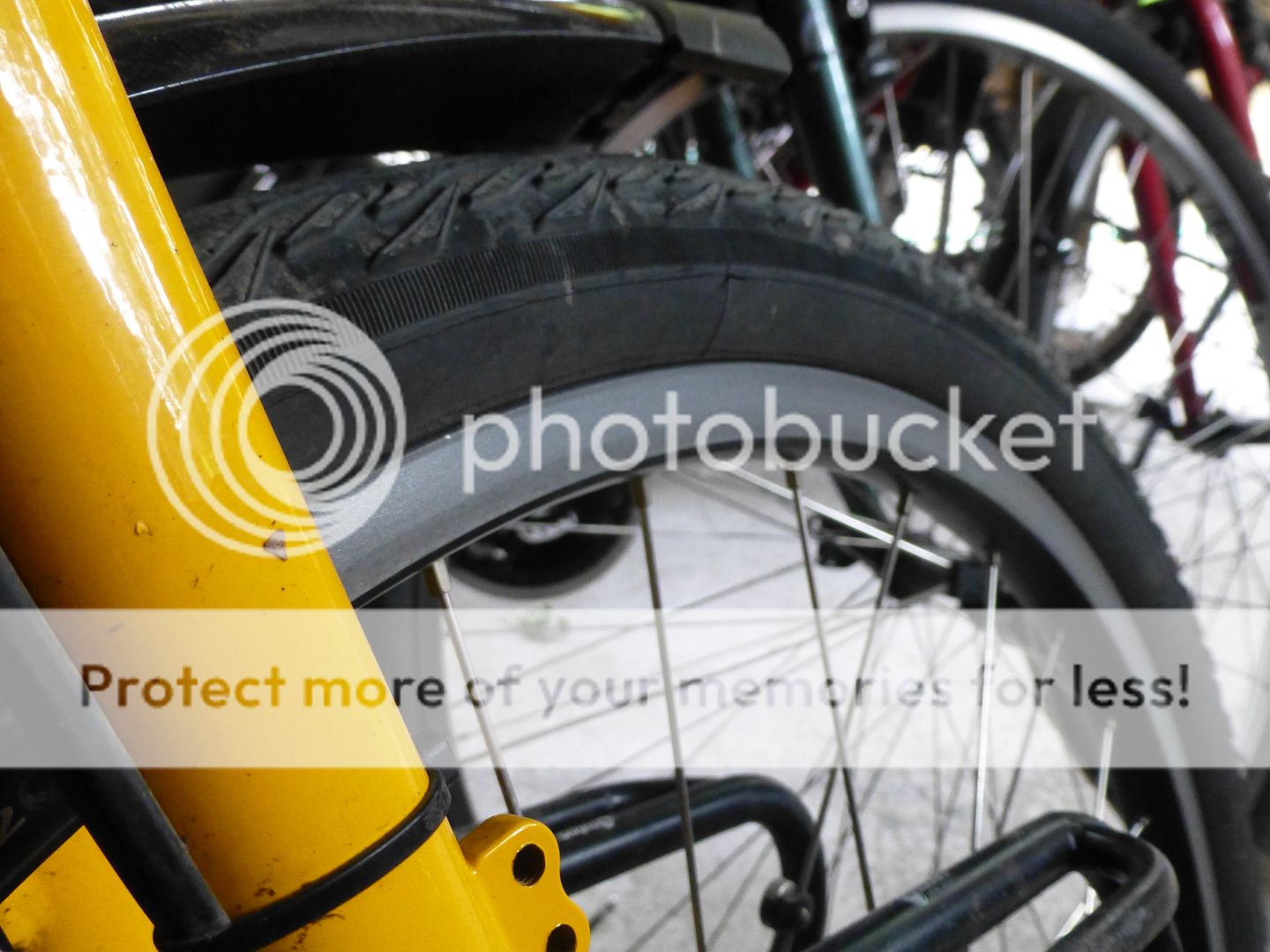

Postby RonK » Fri Jan 18, 2013 4:35 pm
il padrone wrote:BTW if your Surly fork has "through-blade rack eyelets" you could set the bike up with the Tubus Duo front rack and avoid the hoop over the wheel.
Not sure of any good reason not to have the hoop over the wheel. Aesthetics perhaps, but that's in the "eye of the beholder". But I have found it a very useful handle on several occasions.
Posts: 3351
Re: Disk for Rohloff hub - BB7 compatable
Postby il padrone » Fri Jan 18, 2013 4:41 pm
Aesthetics. :wink:
The Duo does the same job, weighs the same, can carry the same load. It's a very rigid rack. The Duo rack can be used similarly as a lifting handle.
[edit] Ah, a bit more compact to pack if you remove it for transport in airline bags/boxes. Small matter I know.
Posts: 15050
Postby RonK » Fri Jan 18, 2013 4:50 pm
il padrone wrote:The Duo rack can be used similarly as a lifting handle.
Err, no. Not the way I've used it anyway. The hoop handle comes into its own when you need help to drag your fully loaded bike through a flooded ford, a bog hole or a sand patch, or to lift it into the back of a vehicle. I've encountered all these situations on tour.
And then there is the issue that the standard Ortlieb lower clips don't fit the 16mm Duo tubes very well, and you have to buy another set for a good secure fitting. Small matter I know.
Posts: 3351
Postby il padrone » Fri Jan 18, 2013 4:57 pm
Err, no. Not the way I've used it anyway. The hoop handle comes into it's own when you need help to drag your fully loaded bike through a flooded ford, a bog hole or a sand patch, or to lift it into the back of a vehicle. I've encountered all these situations on tour.
Yes, dealt with similar. The Duo can be used to lift, with panniers fitted, maybe not quite so easy one handed from the front, but fine otherwise. I generally do such dragging using the seat post and handlebars anyway - dragging using the hoop the bike tends to want to fall over sideways.
RonK wrote:And then there is the issue that the standard Ortlieb lower clips don't fit the 16mm Duo tubes very well, and you have to buy another set for a really secure fitting. Small matter I know.
The Duo main support tubes are 16mm, but the pannier mount tubes are 10mm. Same as with the Tara.
Posts: 15050
