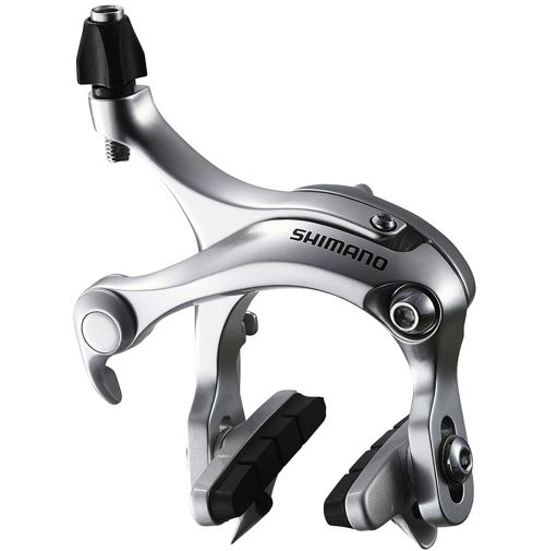

One thing I have found with pre-indexed 80s frames is that brake reach varies immensely from model to model. If you find (as I'm suspecting you may) that series type dual pivot calipers (eg br-5700 etc) don't have the reach required, a set of Shimano r650 calipers are a good option. I believe your frame is drilled for recessed fitting and these are a much better braking option in comparison to Tektro r559.
