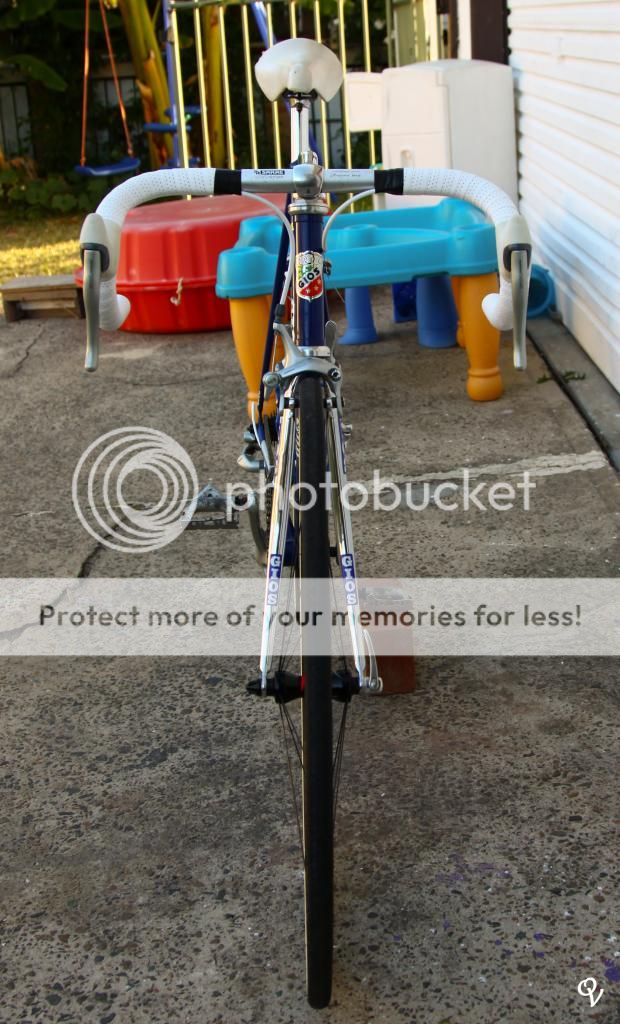

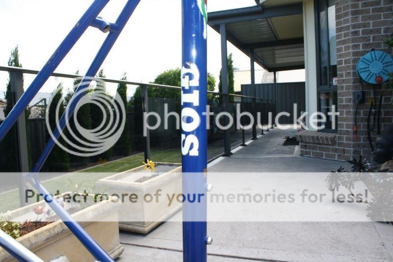

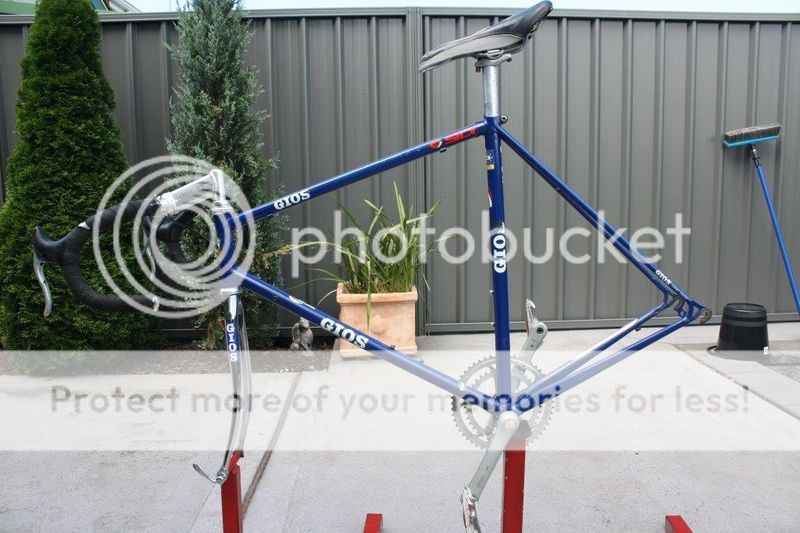

As some of you may know, I purchased a Gios for $75 off Gumtree from some dude up in Newcastle.
Pics from the seller, as I have not picked up the frame yet.
Seems like the seller has owned it for the past 10 years and used it as a commuter. He seems to know his stuff, so I have not idea why he is selling it for so cheap! It currently has a 600 headset, so I assumed that is the original groupset on the frame. Ill be building this up with a 105 groupset though.
Now, theres barely any info on these older Gios bikes. From this site, Gios uses Dedacciai Chrome-Moly tubing, which is equivalent to Reynolds 531/Columbus. How true would this statement be? And did Gios ever have different model names? The majority of them are just called a Gios, with no specific model name.
My frame looks to be a newer model from the assumed original 6400 groupset, meaning early to mid 90s. I also see that it doesnt have any internal cable routing, which is different to most Gios'. Maybe I should bring out the drill. :twisted: Anyone have any idea what model this is? And any more info on Gios in general?

You have purchased a Gios Compact frame.
Other notable models were the Super Record then the Professional. These came before the Compact.

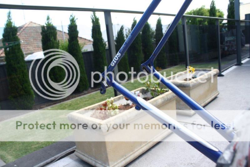

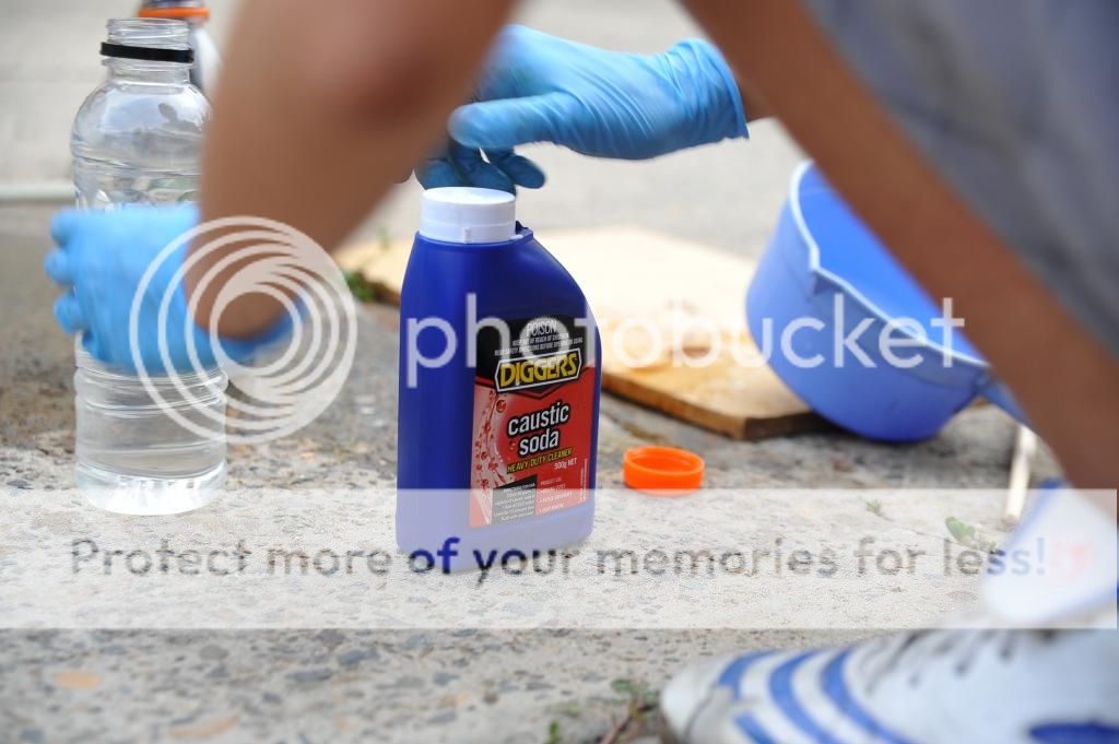

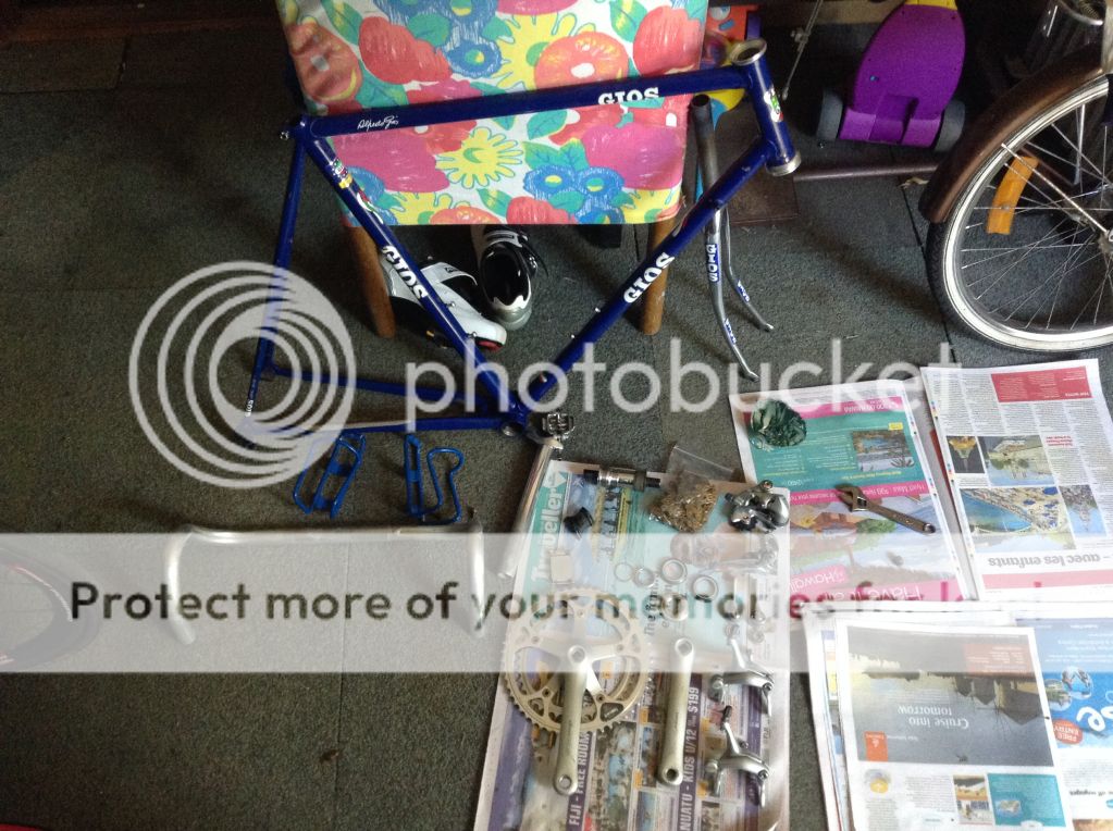

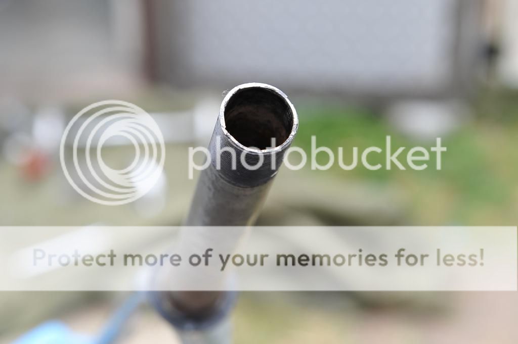

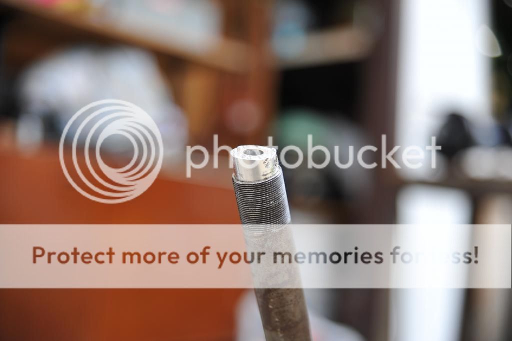

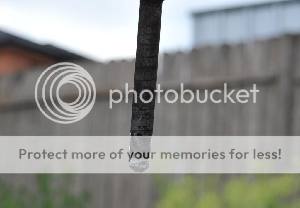

HSC done, and Im back into this. Spent the first half of today heading up to Newcastle to grab the frame. Upon the initial strip down, I got stuck at the stem. It wouldnt budge, so out comes the hack saw. Couldve gone closer, but didnt wanna accidently cut into the nice 6500 headset.
First time trying out how caustic soda goes on attacking aluminium. The stem was about 9cm down the steerer, and is about 5mm thick. So Im guessing itll take a while.
15 mins later, it looks like this. Its currently sitting outside fizzing away. Hopefully tmw morning Ill find a fork with a clear hollow steerer.
Now, there are 2 serials on this frame. The BB one is 9H89. I assume its an '89 frame, which does have an English BB? The other serial which is located on the left rear quarter of the ST near the BB lug is CK002498 MFS F. I guess, Marco Gios will be able to confirm what it is.
Frame with headset cups weighs in at 2150g, which is on the heavier side. Wonder how heavy the fork is. Maybe Ill end up with a 10kg bike.

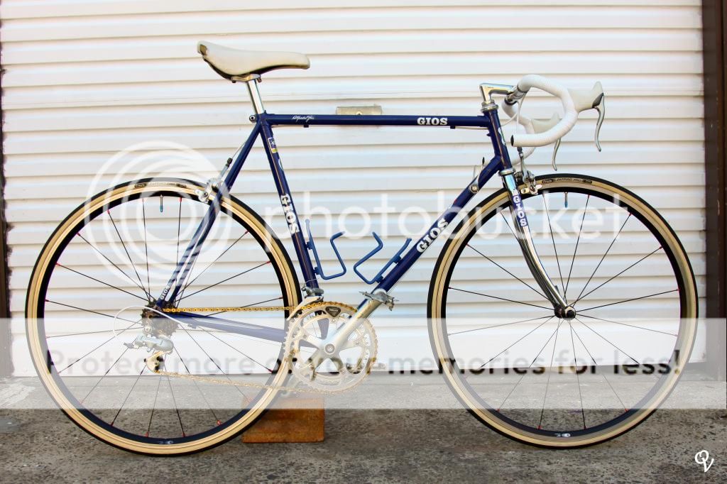

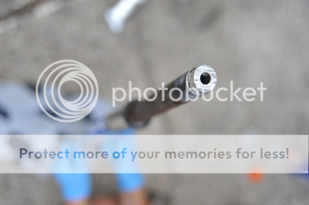

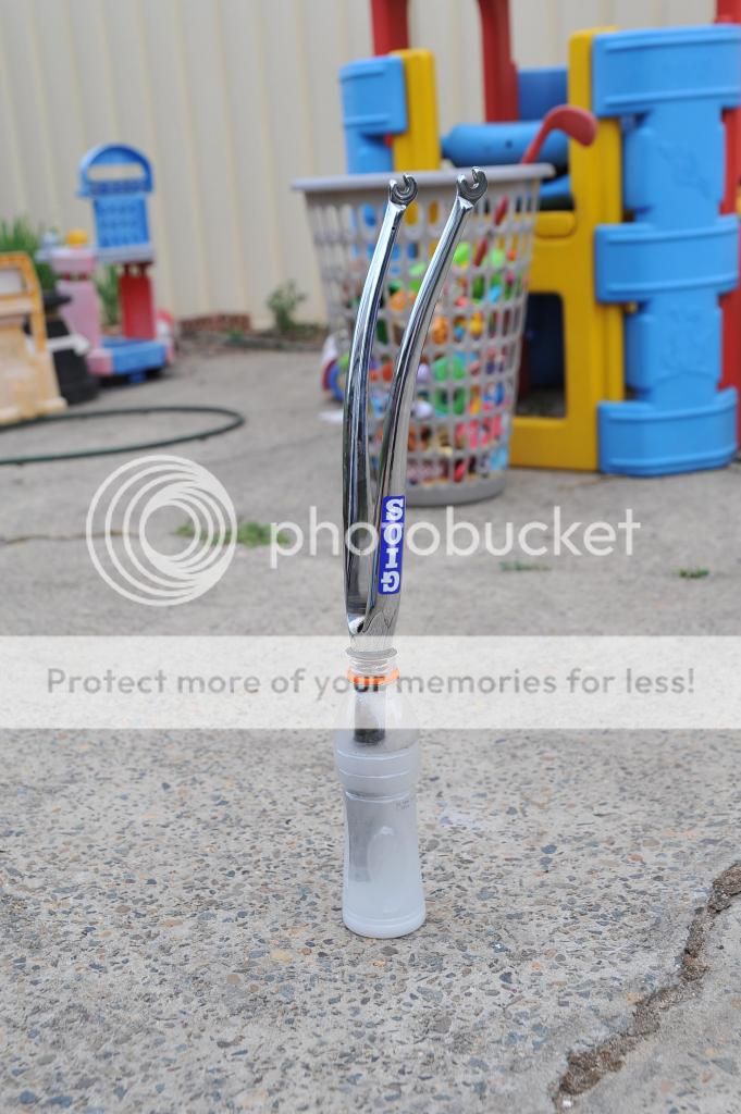

Laggy update since Ive been building the Gios.
Sunday 3.11.13

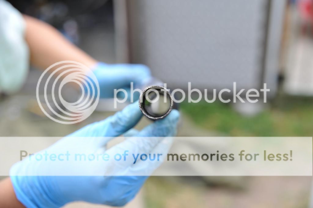

I did not wake up to a clear steerer. The stem was still about 2mm thick. It took approx 19 hours to fully dissolve, and it ended up with this. Looks like I have a way of removing the Bundy's seatpost now.

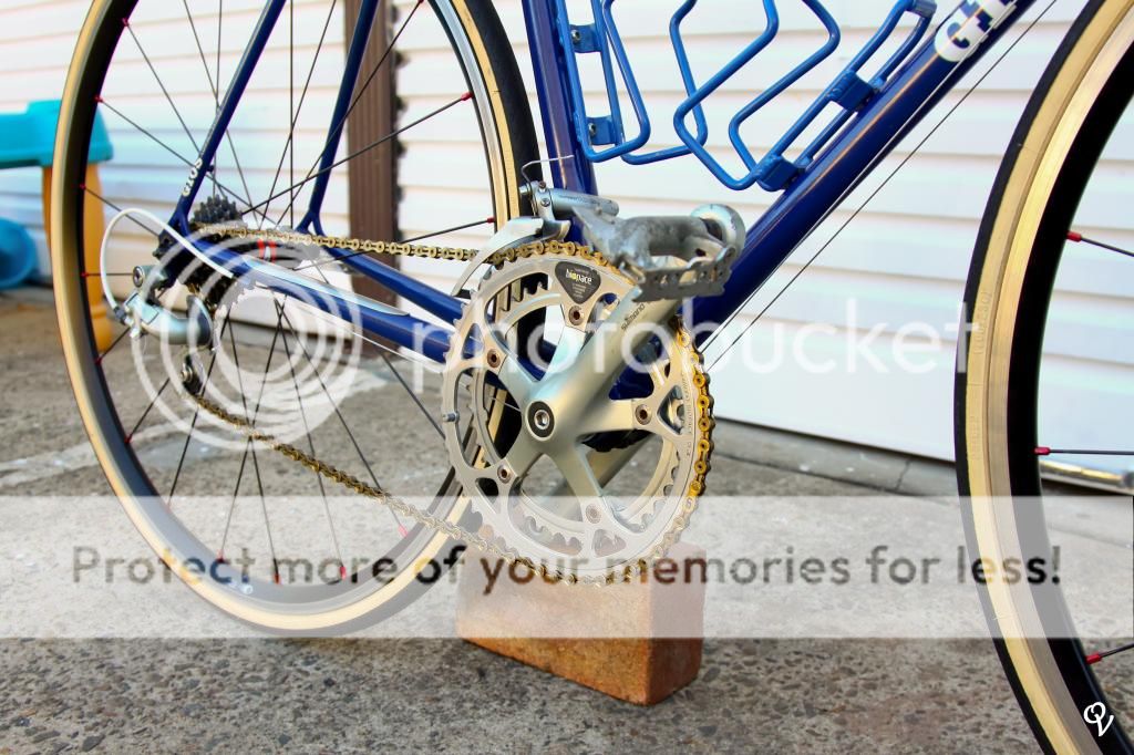

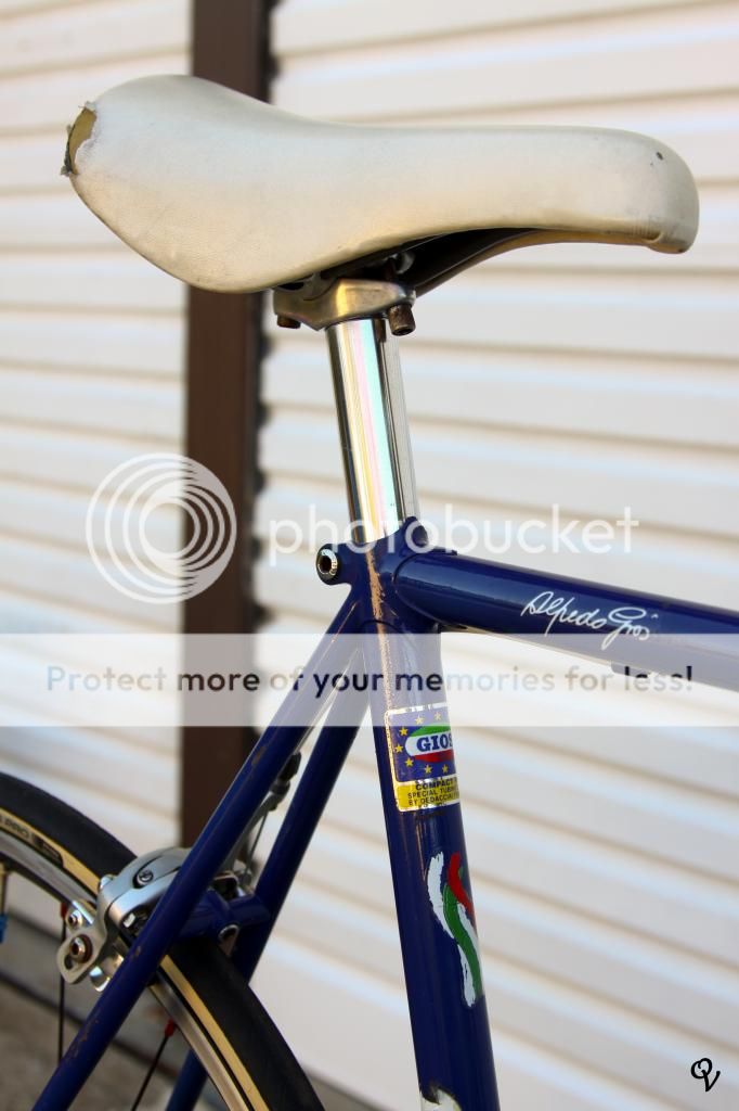

I spent the rest of the day cleaning up the 105 groupset(big thanks to Clydesdale Scot for the 105 levers from his Gios, and the other members who I sourced the missing parts of the groupse from) and polished up the seatpost and stem. Anyone have any idea what seatpost it is? Out the back there was a massive scratch which damaged the printed logo, saying SYSTEM COMP... Its an interesting seatpost clamp design.
Monday 4.11.13

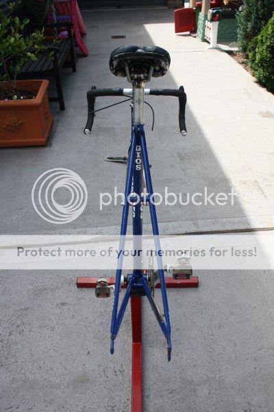

I begun building up the frame. Frame with the headset cups weighs in at 2150g, and the fork at 820g. A grand total of 2970g, a little on the heavy side.
Tuesday 4.11.13
Finished up most adjustments, etc. Bike has ended up being 10.55kg.
Reusing my old 9s gold chain.
Will be recovering this saddle with a new white leather top. This yellowed white looks ugly. Now wheres the best place to source some leather scraps? Lincraft/Spotlight sell by the metre, and is way too much for just one saddle.

Posts: 1801
Re: Gios Torino
Postby Clydesdale Scot » Tue Nov 05, 2013 9:30 pm
Looks good. I like your attention in 'setting' the bike for the photos.

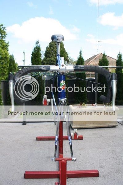

Postby Clydesdale Scot » Sat Nov 16, 2013 5:21 pm

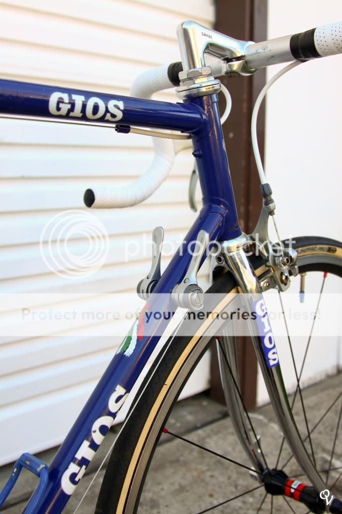

going with the period correct Turbo (for now), and the leather stitched handlebar tape will have a few more practices on some spare bars before I try it on this one.
Just been out for its first ride.
