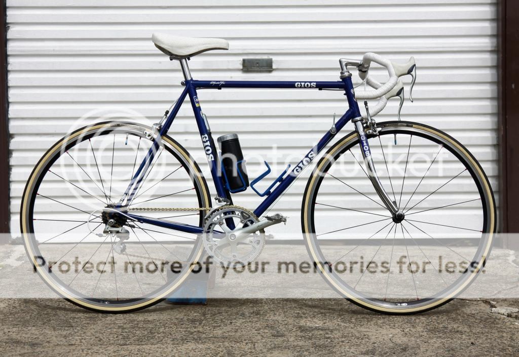

^ destickered Shimano RS20 wheels - 130mm OLD 8/9/10spd freehub with a spacer to run 7 spd, pulled the 126mm dropouts apart to squeeze the rear wheel in

Thanks for all the suggestions regarding the leather. I will just buy a white saddle for this as white leather is hard to come by. Will source some black leather for other saddles though.
Jim, those wheels are just Shimano RS20 without the stickers. I chose to use this wheelset over the Fulcrum 5, as the Fulcrum's red and white decals looked off. What would be a nice touch were if the nipples were anodised blue to match the valve cap and bike. The Zaffiro Pro Classics could be a bit more yellow though.
Philip, yours looks real good! But are you gonna be running a matching white saddle later on? Or is that stitched bar tape youre going with black?
Josh, I had this thread up for like a month before I got started on the build. :wink: It does have a very short wheelbase as you say, being an 89 model.
utedeej, it actually wasnt all that progressively planned out. I just decided to put a 105 group on it since I had most of it lying around, together with gum walls and white accessories to match the white decals. Turned out pretty good too. :mrgreen:

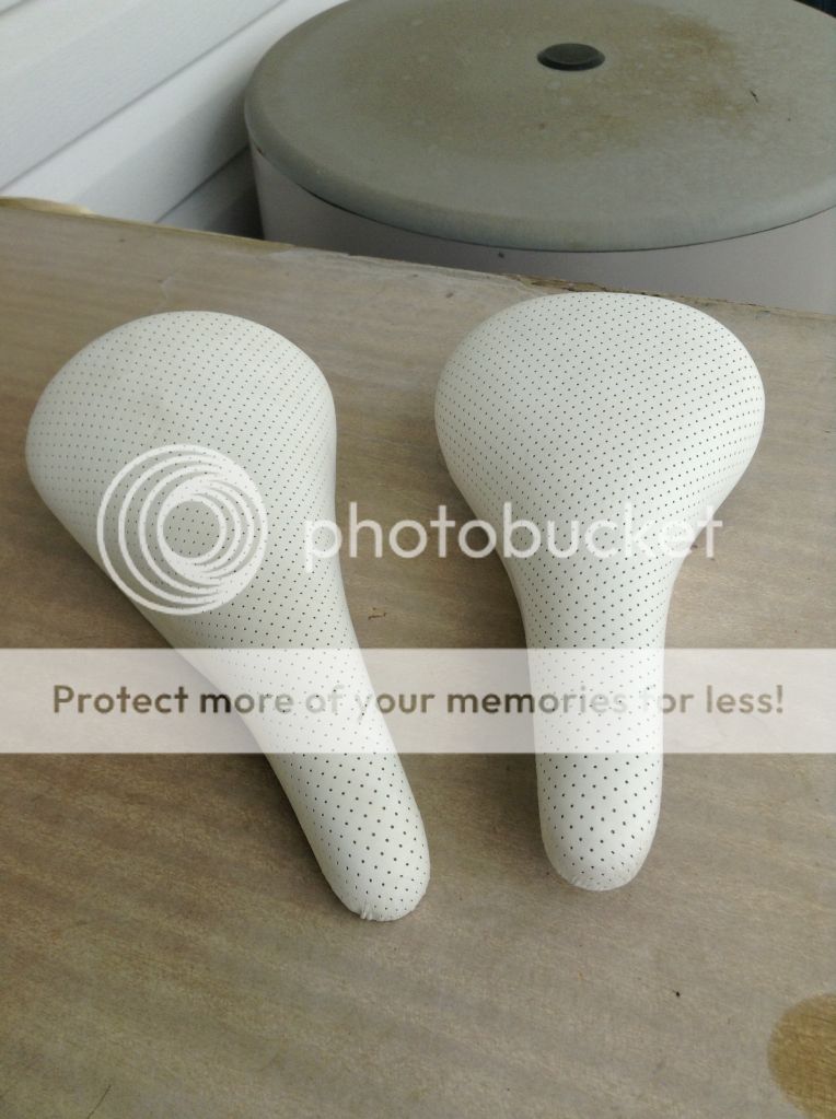

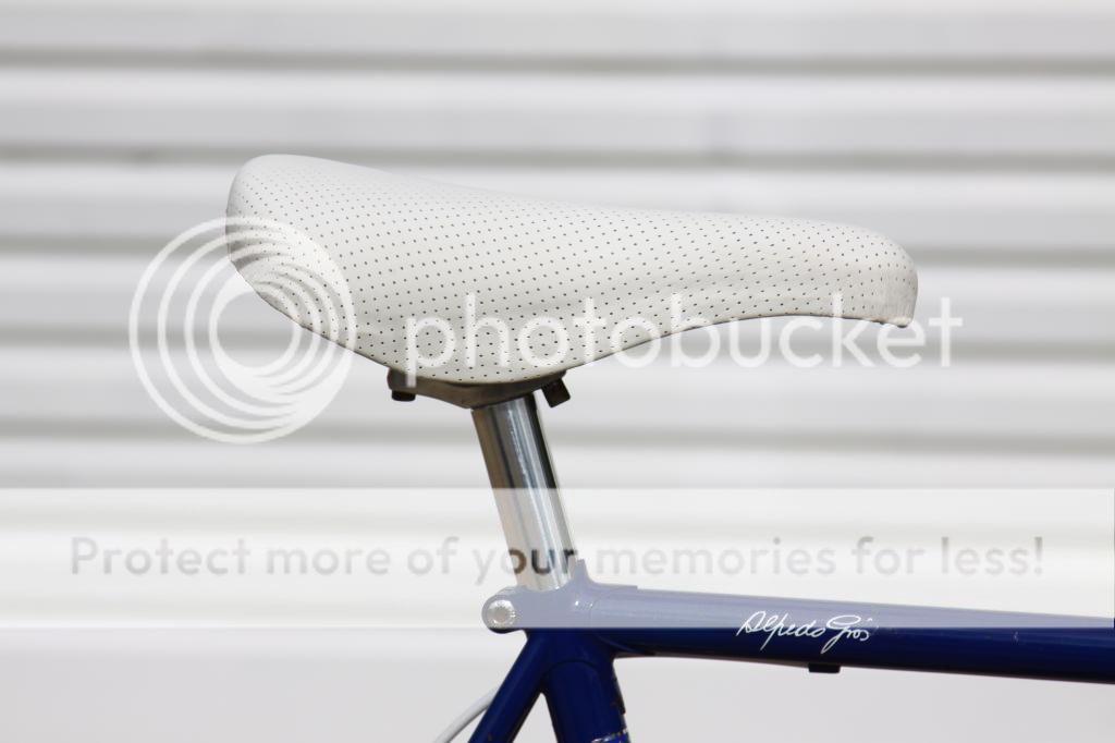

So all the white leather saddles I tried looking for went for exuberant prices. I just chose to go with synthetic perforated material to cover my saddles. First saddle I re-covered is on the left. Only issue I ran into was the nose, as I did that part halfway in, the wrinkles piled up, and I couldnt stretch them away. Went onto a Charge Bucket saddle(fake Turbo), and did a better job on the nose, but had wrinkles out the back. They turned out alright for my first go, but I guess the real test is when I actually sit on them.
I went with the Turbo.
