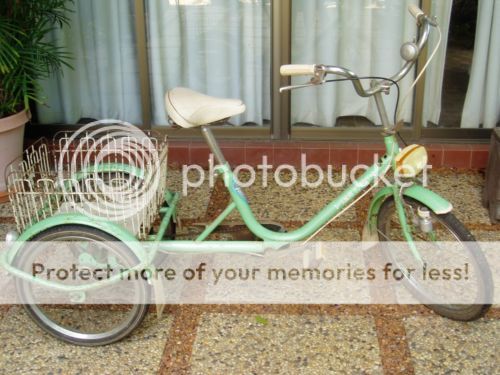

or this option appeals as well
Image :lol:
