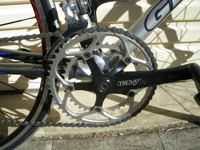

Much of this is probably due to this:
Compare that to the Giant:
Can you say “beefy bottom bracket for improved power transmission”? The frame is certainly stiffer than the Giant, as the wheel flex that I knew existed in my Gipiemme's becomes obvious a little earlier on the Oppy. Over bumps the frame made barely a noise, just the internal cables tapping against the tubes on big bumps. The downtube changes shape to a narrow, more aero central section, before flaring out at the BB. The curved top tube is very much from the Specialized school of bicycle design. Among others.

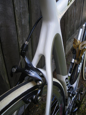

The narrow seat stays dont really come into play under load, though the improved ride quality over small bumps is noticeable. The carbon seat post assists in this area. I could feel decidedly less bumpiness through the seat than the Giant (with its aluminium seat tube and BB shell and titanium seat post) on the maiden Sunday run on the exact same roads as before. The chain stays are squarer shapes, and quite large by comparison, meeting at the bountiful bottom bracket area.
The seat stays are not as big as a Cannondale Six or Synapse series frame, and may not be quite as large as Trek's Madone series seat stays. They look similar in size to the Avanti Cadent and Quantum series frames. I'll pay attention to other bikes and try to get a comparison. They're not wheel-huggers like some more serious performance oriented frames, giving the back wheel a wide berth from top to bottom.
They join the seat tube in a solid connection, with a nice brake bridge detail.
