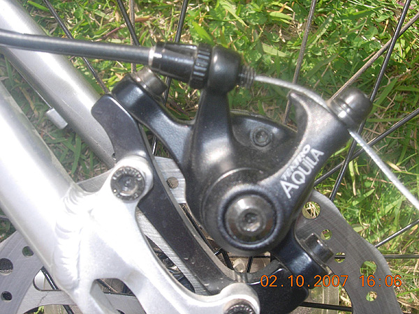

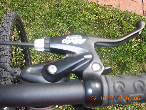

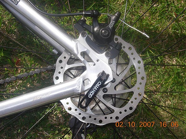

Here are the photos of the brakes:
The levers aren't Tektro, so the knob I was referring to is not there. Can you send us a close-up of the gap between the pads and the rotor please? It might be hard to capture with your camera. When the callipers are set up properly, there should only be enough room for one or two sheets of paper to slip through the gap. If there is more than that, the LBS has not done the job properly.
What they may have done to satisfy your request is to wind the knob on the brake lever (1st photo) back so that it supplies lots of slack in the cable. If that's the case, it's an easy fix - just wind that knob back out until you're happy with the feel of the brakes. This may well be what they have done, since both the knobs controlling cable slack (on the lever and the calliper) are in the extreme slack position.

yeh its like 2-3 sheets of paper on the width...i might go otmorrow to bike shop and ask them....what do i say?do isay i cant skid or what??if i say i skid they'll say thats why its broken....?
