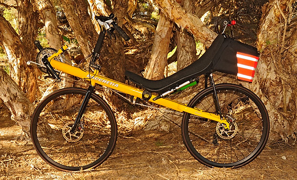

After cogitating for a few months, I finally got my gear together and built up a set of 700c wheels for my Bacchetta Giro 26.
The wheels: Velocity Deep V rims, 32 hole, black non-machined finish ($200). The hubs are XT disc 32 hole ($110) and the spokes are black DT Swiss double butted (32x280mm & 32x282mm) with alloy nipples ($125). I built the wheels up myself (wheelset total cost: $435)
The tyres: Continental 23c Ultra-Gatorskins with Mr Tuffy liners. Pressure = 110psi
First impressions: LOVE 'EM!!!! I now wish I had done it much earlier. Aside from being significantly faster, the ride is actually smoother than my 26x1.25" slicks (AT) 100psi, most likely due to the larger diameter wheels. The rear hub runs nearly silently, which is a relief after running my Hope XC hubs (my MTB wheels) since getting the bike in April. The silence seems to make the ride "feel" smoother when I'm coasting.
I was expecting to have some minor stability issues with the change in wheel diameter (fork rake and trail, etc.), however that has not eventuated. In fact, if I had to make a call, I'd say the bike feels more stable than before (maybe due to the ~25mm increase in the centre of gravity height?).
I have yet to encounter a steep hill (not many around here) so I don't know how the loss of my lowest gears will pan out. The hills I have hit didn't slow me down as much as I thought they would (due to the reduced rolling resistance.?) I'm hoping that translates well to the steepest hills, and the lowest gears will not be missed too badly.
The raising of the seat has not been a problem when I'm stopped and sitting on the bike. I thought I might feel a little stretched out, but I've been pleasantly surprised.
The Verdict: If you are considering doing this upgrade, don't wait.

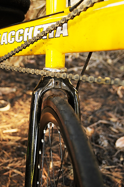

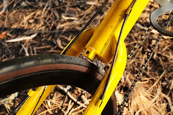

How much clearance is left in the fork and frame with the big wheels in? I gather that there's enough space to fit tyres up to about 28mm width, does that sound about right? Any chance of squeezing a set of narrow mudguards in there when using 23mm tyres? Not an essential feature from my point of view, but it'd be nice if it was possible.

Here are the photos of those areas you mention. I've just been preparing them to post as your questions came online.
I'd say you can easily fit 28c tyres on the rims. There is a lot of room either side of the tyres, but not much between the outside edge of the rear tyre and the frame (say 5-8mm?)

Thanks for the photos Graeme, very helpful.
Looks like the limiting factor as far as tyre size goes would be interference with the rear calliper brake mount. On the Bacchetta forums I've heard of people grinding the corner off that in order to squeeze moderate width tyres into the notoriously tight Corsa frames, but as you say there seems to be enough room on the Giro frame for at least 28mm as is.
It even looks like fitting a standard mudguard on the front would be no trouble with 23mm tyres. The brake mount would get in the way at the back if using the official mounting points, but you could probably rig something decent up by using the vacant brake mount as the forward attachment point instead of the braze-on under the tube.
