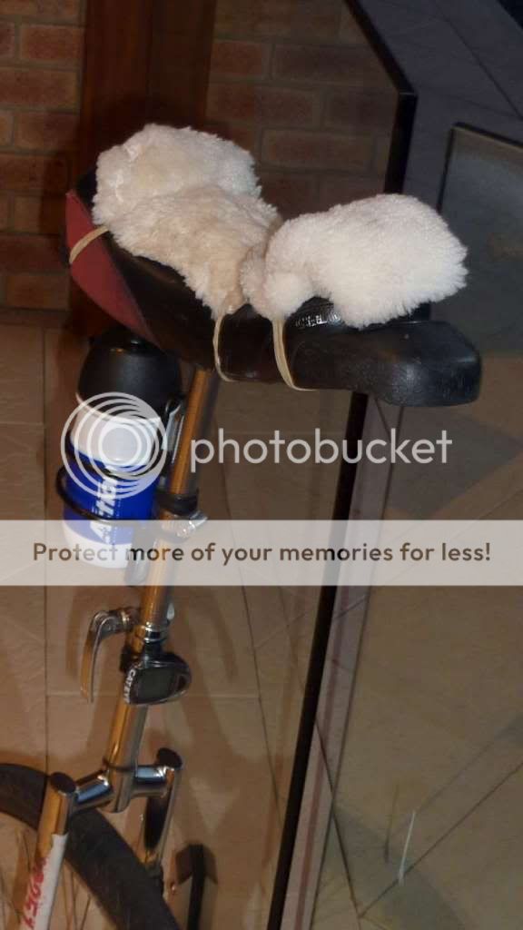

I may not have the same hardware (or should that be SOFTware) as you but, because of my particular type of ride, I am highly challenged when it comes to stretching and wearing those soft bits. Indeed I used to wear raw in the scrotum until I worked out my own solution. Damned painful.
What has worked for me is a lambswool pad cut to fit the seat and held on with plain old lacky bands. And a silicone based barrier ointment like Resolve or Silic15 on occasion, mostly when it is hot.
The lambswool has to be skin that is tightly curly rather than long soft hair. A complete skin will set you back around $120 but you would get a dozen or many more out of it. I have multiple pads and change them regularly. I just throw them in the washing machine with the rest of the wash. The pads are cut to NOT encroach too far over the edge of the seat, more to sit on top but whatever works for a particular problem... If nothing else the lambswool will take the pressure of the perineum.
The ointments are supposed to be put on only after you are dry. Only need a little.
A pic attached. It looks bulky but once you settle down on it it flattens down. Mine is also doubled over but a single strip would likely be ok for you. Periodically I will move it back or forward if I find that it is losing effectiveness and I am in the middle of a ride.

Colin, can you read the Cateye when moving?Image

ColinOldnCranky wrote:Image
:shock: :shock: :shock: If I had that on my bike, no one would ride with me. come to think of it, I wouldnt ride with myself.
