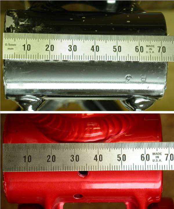

Jonny Watson from United Kingdom asks
how do i measure the size of a BB from the frame - if i havent got an old BB to measure????
CRC Replies:
To get the correct BB size you will need to measure the Width of the bottom bracket on the frame. It will be 68mm or 73mm on a Mountain Bike. The axle length depends on the cranks, as a guide, most modern ISIS cranks use a 113mm but there are exceptions

It is easy enough to measure you frame to see if it is 68 or 73mm.
You can also remove the cranks and measure the spindle length.
The easiest way is to remove the bottom bracket and read what is written on it. This also allows you to grease the threads and reinstall useful to do this to get rid of noises.
