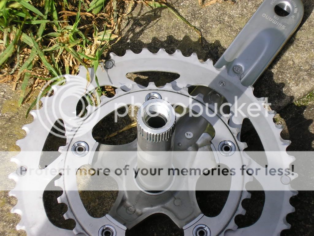

Postby Nobody » Tue May 01, 2012 8:57 am
I found it interesting that while some of the Shimano road cranksets have Al spindles, the M770 XT MTB cranks are steel. So I just replaced my 105 5650 compact road crankset with 5750 to find they are now using steel spindles in these too. Maybe they had a few more failures in Al than they thought they would and so went to steel. Good for me as I'm happier to keep these a bit longer and just replace the chainrings next time.

Postby warthog1 » Sat Aug 18, 2012 4:58 pm
There looks to be a fair thickness of metal on that tiagra crankset.
Seems unlikely to fail to me :? especially with the limited power I am able to generate :oops:

Postby Nobody » Sat Aug 18, 2012 7:02 pm
warthog1 wrote:There looks to be a fair thickness of metal on that tiagra crankset.
Nobody
Posts: 5758
