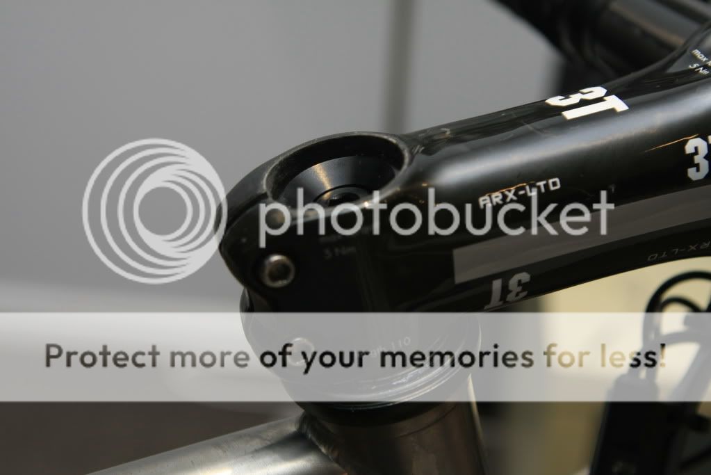

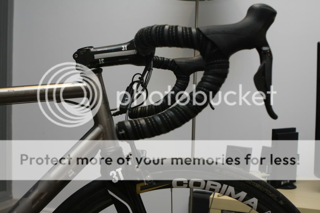

Re: No Compression Washer, is it safe??
Postby baralah » Tue Oct 09, 2012 8:39 pm
Pics attached, thanks
Postby ZepinAtor » Tue Oct 09, 2012 9:30 pm
Soon to be seen................WTB-SYD-New 3T fork.
Sorry Baralah, but that fork has only one place & that's on a smaller frame.

Postby baralah » Tue Oct 09, 2012 9:32 pm
Sorry for my ignorant. Is below headset external cup or internal, I can't find any information from the spec? The picture looks like it's external. If it is external, I may have a solution since the total stack is only 12mm.
http://www.wiggle.co.uk/cane-creek-40-series-zerostack-1-18-inch-headset/
Postby ZepinAtor » Tue Oct 09, 2012 9:43 pm
Looks like an external cup type which may "just" save you.
Have you thought about selling your fork & buying another ? They aren't that expensive in the scheme of things.
Postby jacks1071 » Tue Oct 09, 2012 10:30 pm
baralah wrote:Sorry for my ignorant. Is below headset external cup or internal, I can't find any information from the spec? The picture looks like it's external. If it is external, I may have a solution since the total stack is only 12mm.
I don't know much about cane creek headsets - if that'll fit your bike you can measure up what you've got and work out what you would gain by the lower stack headset.
Your stem looks like its one of the deeper ones so you should be able to find one that isn't has high to gain a few more mm.
Its going to be pretty tight.
Its a bit late to tell you this now but when we cut them, we fully assemble the fork in the bike with the headset, stem, spacers etc - then we mark it. This way there is zero chance of making a mistake.
Postby Mulger bill » Tue Oct 09, 2012 11:09 pm
New fork time mate. I really doubt the inside of the headtube will be correctly machined to accept a zero stack headset.
Postby baralah » Wed Oct 10, 2012 10:09 am
Mulger bill wrote:New fork time mate. I really doubt the inside of the headtube will be correctly machined to accept a zero stack headset.
thanks boys, new fork it is
