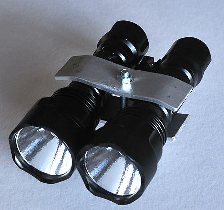

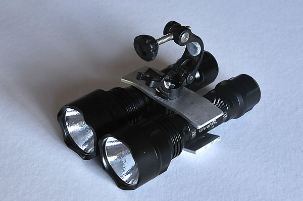

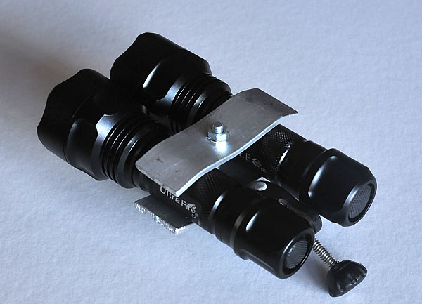

With the current spate of threads about using the latest generation of LED torches as bike lights, I thought I'd share my mounting solution with you guys.
Firstly, I've purchased three of these torches to be used as bike lights. Two are to be used mounted on the bike while the other one is a spare light to be carried in case I get caught after dark without my normal lights (it's a spare to be carried around). I needed a secure way to mount the two on the bike, since the supplied mounting blocks won't fit where I need them to be mounted and still let my cranks turn (that's another story).

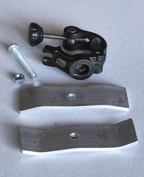

With that in mind, I made up the following mount using a couple of strips of aluminium, a bolt and nut and a clamp from my VistaLite set (which these torches replace).
I bent the outside 10mm of the strips of Al using a pair of vice grips to provide a secure mounting plate. The bend in the middle came about when I tightened up the nut on the bolt.
What you end up with after assembly is what you see below.
And finally, when the torches are mounted on the bike:

Nice work Graeme, some inner tube recycliing over those strips for grip and protects the finisf of the torch me thinks.

Yep, that will happen after I've made my battery pack and hooked up the wires. I made this in about 10 minutes before going out on Friday evening for a ride. I wanted to see it this would work even with the batteries in the torches (I'm going to use foam-core instead of dowel to keep the weight down.)

mikesbytes wrote:Where did you get the screw thing that looks like it would mount on a handlebar?
The clamp is recycled from a set of VistaLites.

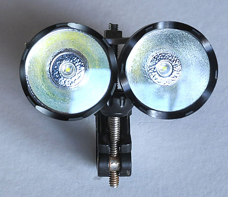

I'd say the beam spread is not "ideal", in that it's quite narrow. But it's so bright that the spill is enough to see by. I quite like it that way - I get a great view of obstacles long before I reach them, which lets me choose my line more effectively.
It seems my alignment of the two torches is too good! I don't get any spread across the path - just a strong light out in front. It wasn't a problem last night, and I also had my HID on my helmet (ineffectual as it is now, by comparison with these things). I reckon I'll put a little piece of neoprene between the cones of the torches next time I hit the single track, just to spread the light sideways a bit.
