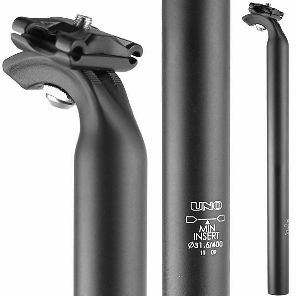

The seat post. I think is one of these
I need the nut with the little serrations on it.

Oxygen debt is still impairing your cognitive functions. 8)
The serrated part is a "washer" for want of a better word between the head of the bolt and the seat post. On my bikes it is an allen headed machine screw. (Technically a bolt is only threaded at the end.)

JustJames wrote:The serrated part is a "washer" for want of a better word between the head of the bolt and the seat post. On my bikes it is an allen headed machine screw. (Technically a bolt is only threaded at the end.)
Agreed - I have a bolt at the moment (only machined at the end) but no washer - I need a source for the washer (and probably something better than a mild steel bolt)
