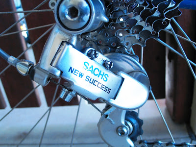

A few days ago I had an hour spare, so finalised a few things on the 'crosser. What's wrong with these pictures:
Works flawlessly :D
Velo13

Postby Dan » Mon Nov 19, 2012 11:08 am
Velo13 wrote:Works flawlessly :D
Love it :D
