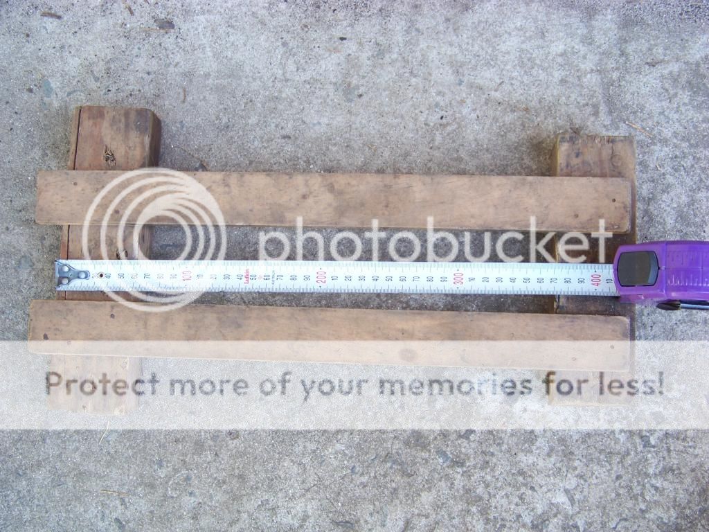

Wheel chock for front wheel. For those who don't want/need to use a stand but still don't want the bike moving around much when doing basic maintenance while leaning the bike against something. The idea here is to keep the tyre off the ground so the front wheel weight is on the chock. The inner dimensions of mine is 31 X 6cm which will do most road and MTB tyres. You can see the wear marks on the wood beside the measuring tape. I've been using this one for years.

Nobody wrote:Image
Wheel chock for front wheel...The inner dimensions of mine is 31 X 6cm...
I forgot to mention and important measurement which is the block height at each end. In this case it is 45mm. Obviously block height will affect ideal inner length so you'll have to estimate from whatever wood you have to keep the tyre just off the ground.
Anyway, when I do need to do wheel work I use the trainer, with a car stand under the BB for the front wheel. I also find a peg and an old spoke are handy for truing and a tape measure for dishing. Of course none of this is new, but it might help someone to DIY in the future.
