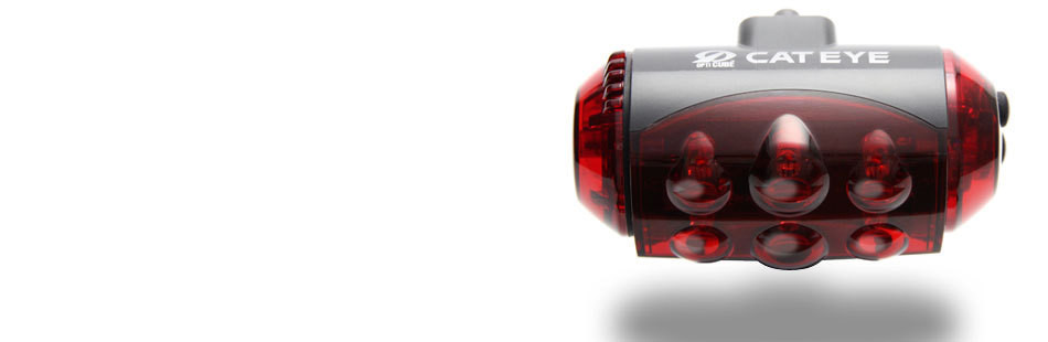

KonaCommuter wrote:Those E3 tail lights don't strike me as being visible from the side of the bike. Happy to be wrong
The LED's do protrude, so some side illumination would be visible - how bright is the big question?
Hmmm, mine don't protrude at all. I have the rack mount version. Interestingly, Supernova seem to have admitted there is a problem, and now offer a new model E3 taill light with better side-visibility. So that must be the one you have.
Does not help with my problem, which is that the light is not particularly bright when stopped at traffic lights, and could easily be lost in a background of car brake lights, which puts me at risk of being rear-ended. A bright flasher is essential as far as I'm concerned. This is the one I'm using.

Postby Crawf » Fri Aug 03, 2012 2:12 pm
RonK wrote:Does not help with my problem, which is that the light is not particularly bright when stopped at traffic lights, and could easily be lost in a background of car brake lights, which puts me at risk of being rear-ended. A bright flasher is essential as far as I'm concerned. This is the one I'm using.
Have to agree with you there, the 'standby mode' when stationary is next to useless amongst traffic - but I always have additional flashers front and rear too, so not a biggie for me.

Postby KonaCommuter » Fri Aug 03, 2012 2:29 pm
I'm a huge fan of that Cateye model. It was my first "serious" rear blinkey. I'm currently using the Tioga dual eyes tail light on my Oppy road bike and I'm happy with it.
Battery life on both the Cateye and Tioga is excellent. The Cateye is heavier but it does have superior visibility from the side and it does have redundancy in that it is basically two blinkeys in one with two switches, two circuits and two batteries.
Thanks for the advice. I will skip the tail light for the time being. I had thought that it'd be possible to braze on a cable guide to make it look all professional but that's a negative according to my LBS. And I do want my bike to look nice, that's why I'm going to pay extra to buy the anodised black version of the Hub
