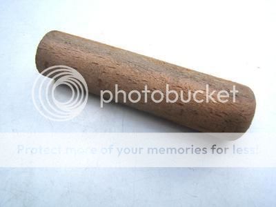

Postby tedsbikes » Sun Dec 16, 2012 9:13 am
New wooden inserts for forks are still available - see http://www.ebay.com.au/itm/251199738765 ... 1438.l2649

Postby Clydesdale Scot » Wed Jan 02, 2013 6:35 am
and some for sale
