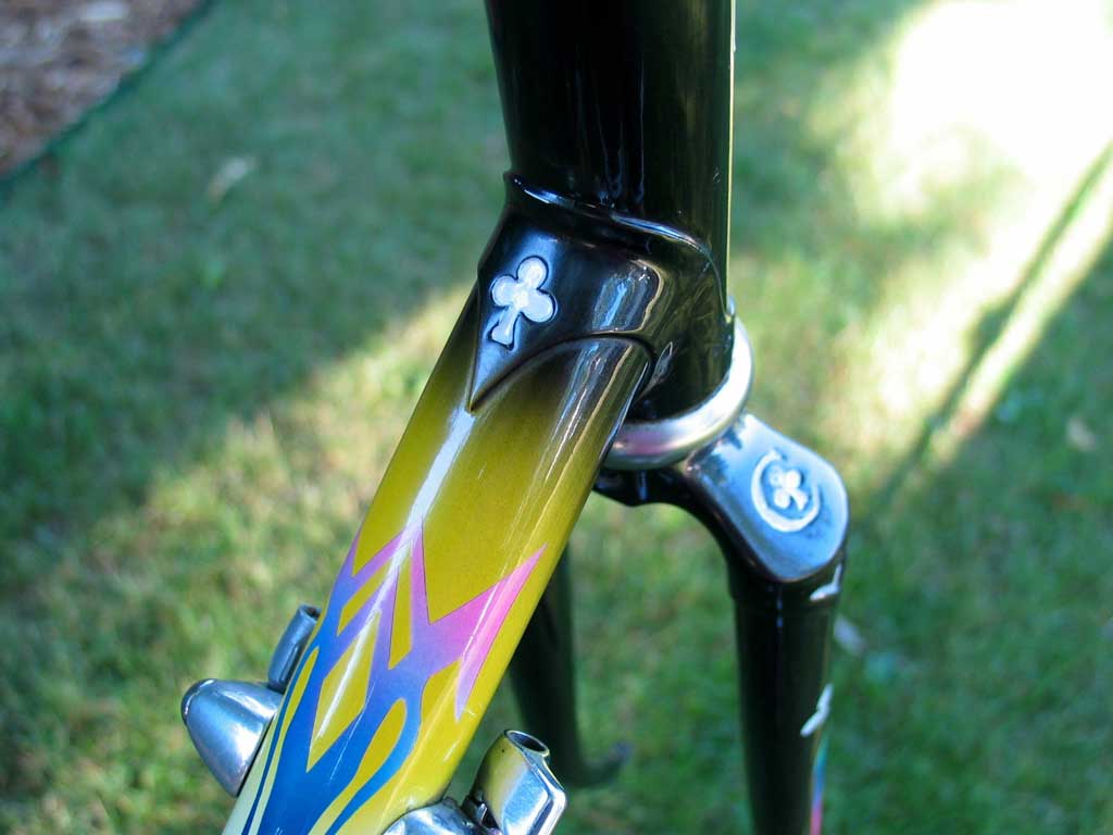

does it have any club shaped cutouts under the bottom bracket or filed into the lugs?
no clubs, no colnago.

munga wrote:does it have any club shaped cutouts under the bottom bracket or filed into the lugs?
Yep, that the clue...
Posts: 6986
Re: Colnago, real or fake? Pls help
Postby munga » Fri Dec 21, 2012 12:16 pm
there are always exceptions to the rule, but pretty unusual to see a real colnago without the clubs.
also check the seatpost diameter, should be 27.0mm or more commonly 27.2mm
check the dropouts - should be stamped campagnolo, or colnago.
once again, exceptions to the rule do exist - i'm no colnago guy.
