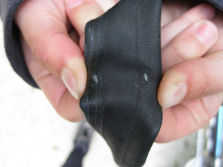

Unless you are using a very very small tube then it will stretch to fill the available volume without too much trouble.
It's quite likely that the tube has been nickedd by a lever or was caught between the rim and tyre bead during installation. A classic pinch flat is caused by a heavy impact-like a pothole-which pinches the tube between the tyre and the rim.
It will also typically leave two holes in the tube which is why it is often called a snakebite puncture.
