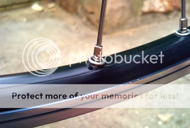

This happened just after Xmas/New Year. It's the back wheel and it's done about 11,000km. That's OK I suppose, but nothing like what they should do. No doubt the tension was a bit high, but these wheels were my first DIY build and I don't use a tensionometer.
The good thing about DIY though is the wheel is easily rebuildable, even if I did have to wait a bit for a new rim from Italy.

Hi Jean. Which brand rim is that? You say Italian, so is it Ambrosio? How many rear spokes and what do you weigh (if you don't mind me asking)? On my recent build using a Kinlin XC279 (23mm wide, 28mm deep) the rear drive side was tensioned to 130kgf. Box section rims such as the Mavic Open Pro don't take much tension at all (Mavic recommends 70-90kgf). So you do need to be careful with those type of rims and not over tension.

Yeah, it's an Ambrosio Evolution - as you say a pretty standard box section rim. I've been toying with the idea of a tensionometer, and I'll probably pick one up sometime this year. A 'good to have', but no great hurry.
Edit: Sorry to fully answer your question, it's a 36-spoke rim and I'm a Clydesdale.

Jean wrote:This happened just after Xmas/New Year. It's the back wheel and it's done about 11,000km. That's OK I suppose, but nothing like what they should do. No doubt the tension was a bit high, but these wheels were my first DIY build and I don't use a tensionometer.
I am in the middle of rebuilding my rear wheel for exactly the same reason, except I have 10 spoke eyelets looking much worse than that. Two large chunks of rim missing, and under the rim tape was a horror sight with the top part of the rim pulled right through.
I have been pretty slack because a saw the cracking late last year when I replaced the hub, but I had no spare rim (or time) so I just kept a close eye on it.
I suspect the bike shop may have over tensioned the wheels when they first built them, or it was a dodgy rim (was a NOS Open Pro rim).
Here's the transplant pics:-
