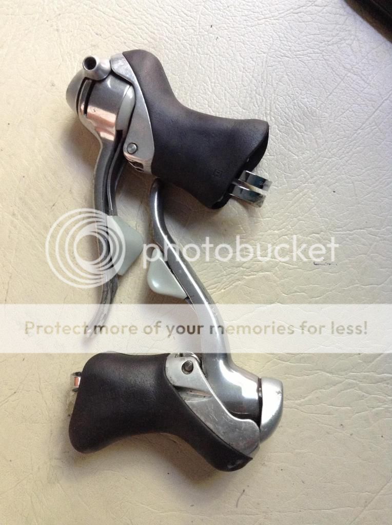

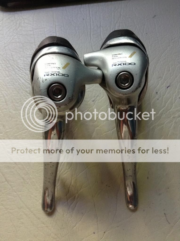

Another guide, now for the RX100 STIs. These were in lovely condition, and its obvious they did not get much use over the years. However, the left hand shifter did not click at all. Right hand was quite stiff when clicking. Obvious signs of the gummed up grease.
RX100 levers are not symmetrical. The right side lever is different to the left side lever. So I will be going through both left and right sides in this guide.

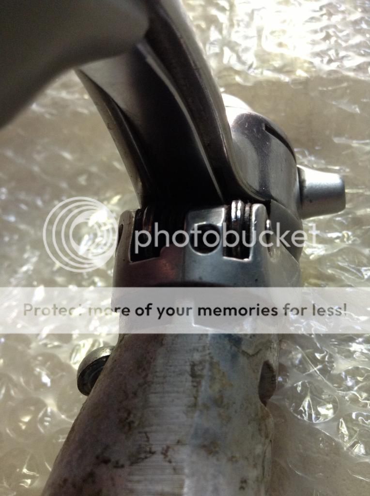

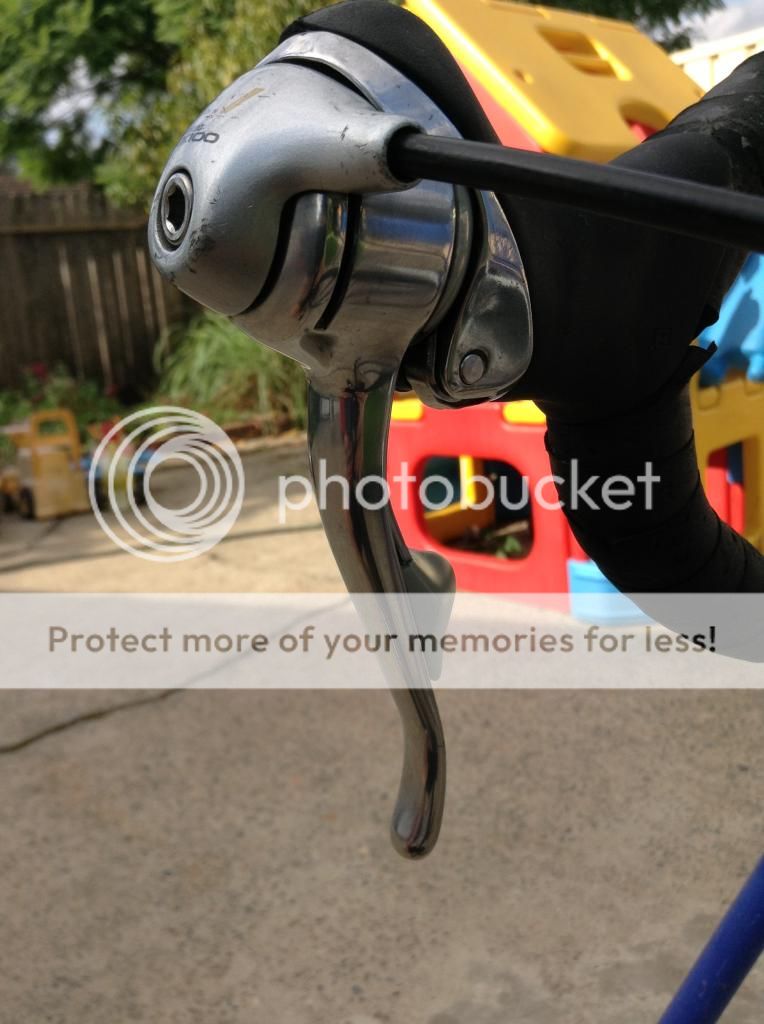

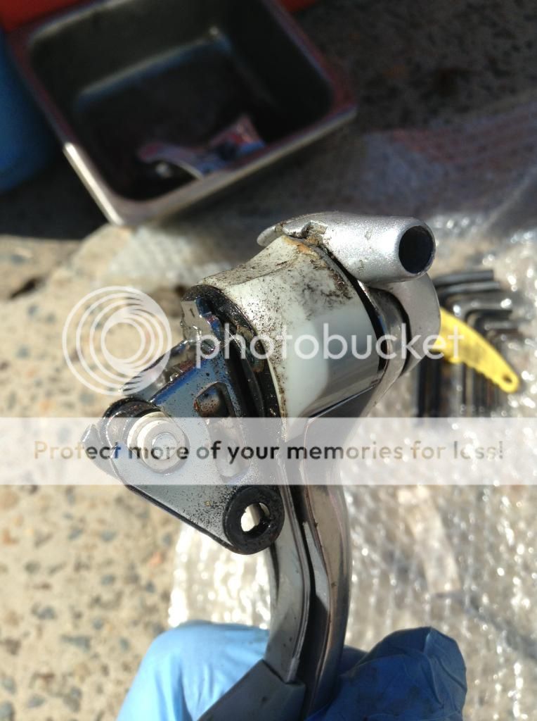

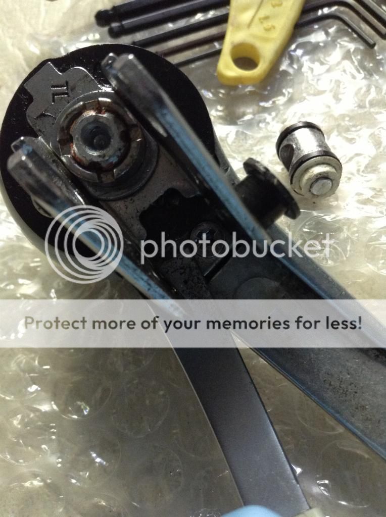

This is the right lever. Remove the hood, and use a 2mm allen key to remove this grab screw. It does have a little bit of threadlock, so it may be a little hard to unscrew.
Use the same hex key to push out the pivot. Now you can take the lever away from the body.

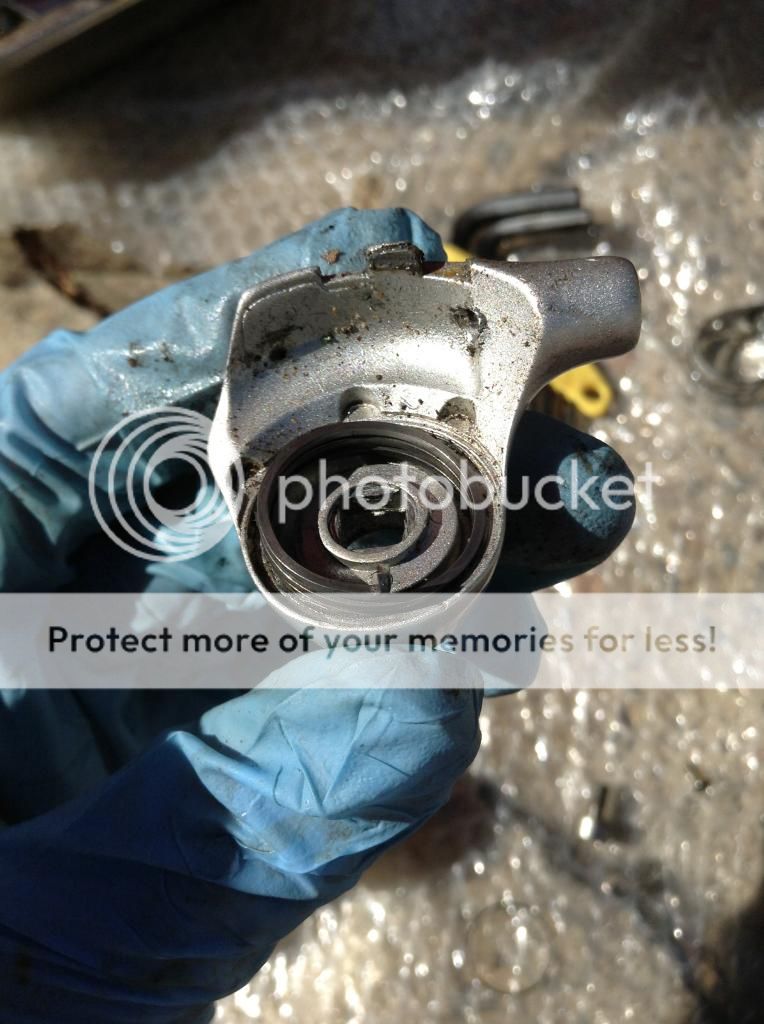

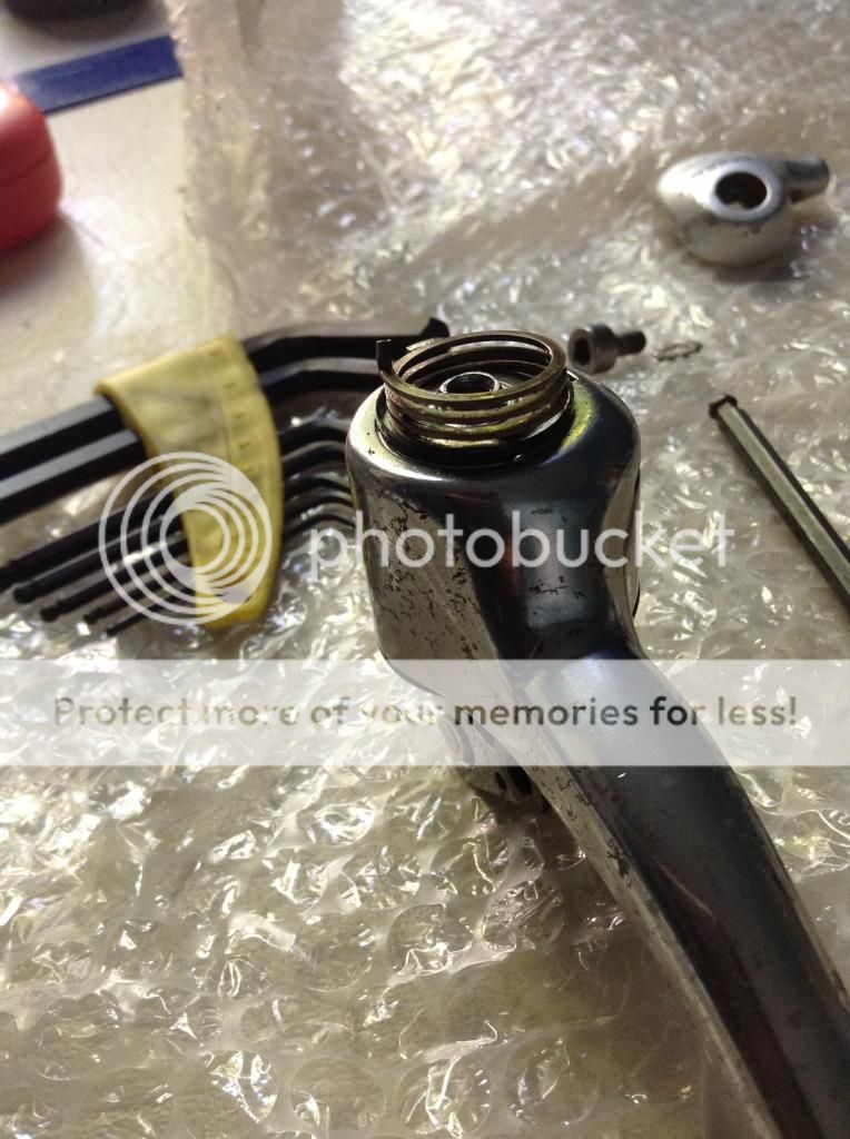

Next, use a 5mm hex key to remove the screw holding on the name plate. Make sure youre holding onto both the name plate and the lever when unscrewing.

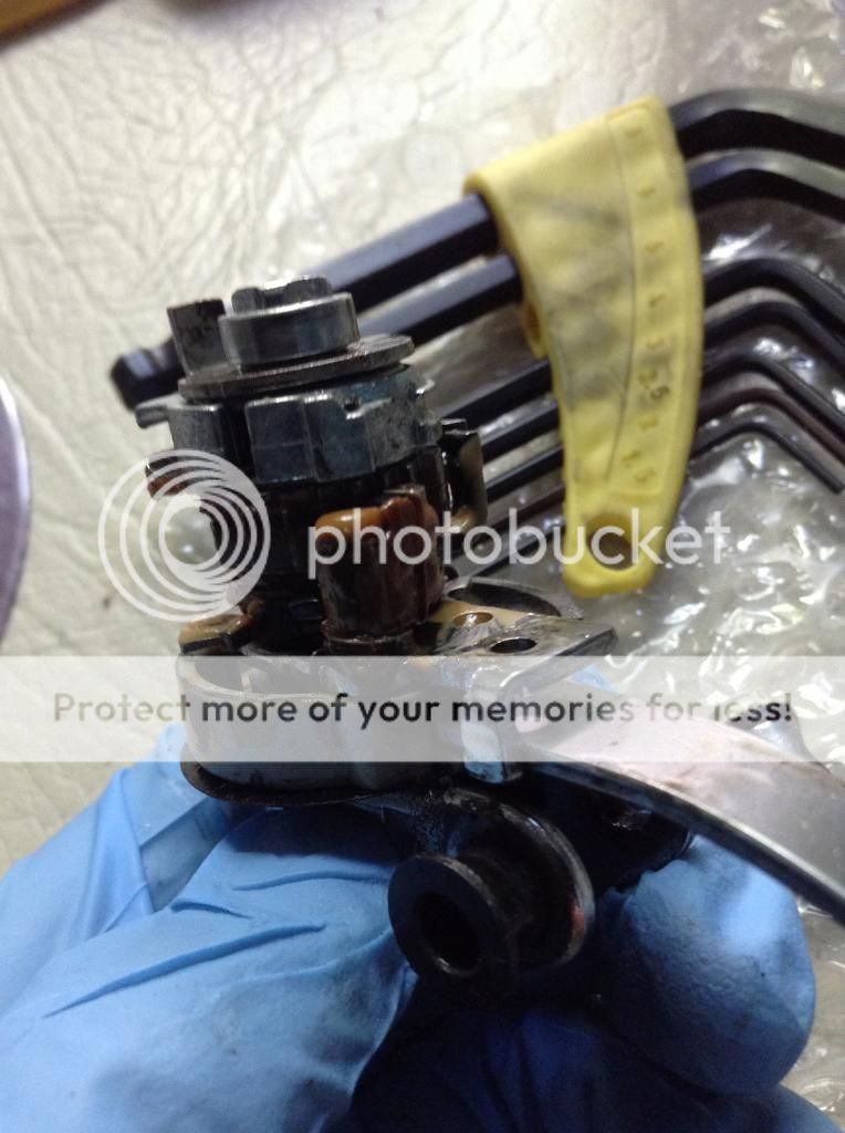

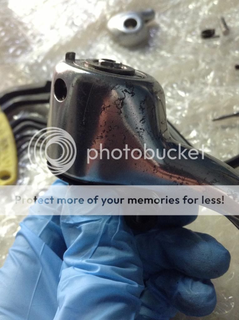

You will be greeted with this spring. This is different to the assembly of the new Sora(3300) and 105(5500) levers. Id say its much more easy to dismantle and rebuild because the spring is here.

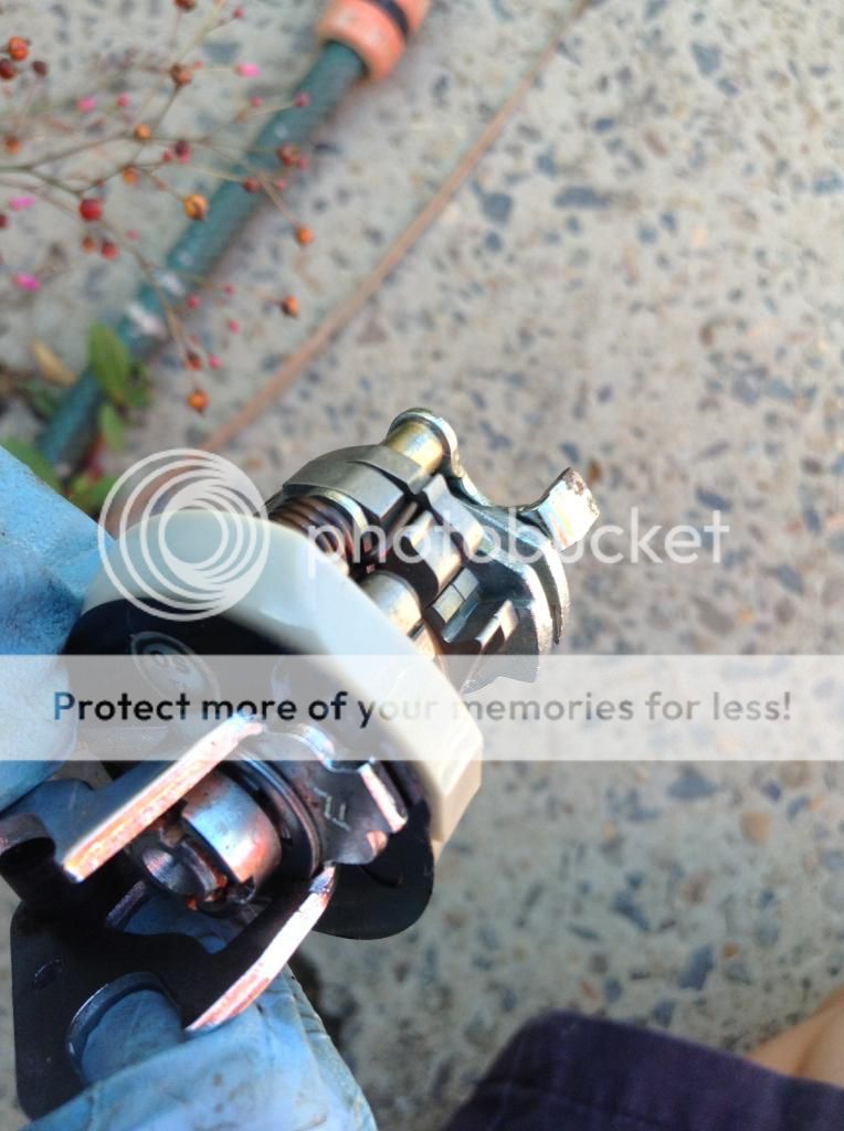

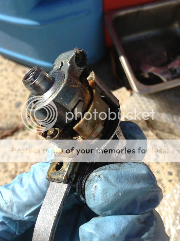

Now flip to the back side of the lever. Push the smaller lever over so the screw is visible. Unscrew with a small Phillips, and watch out for the small washer underneath.
Now, just pull the lever right off. No springs underneath like on the new levers, so its very simple.

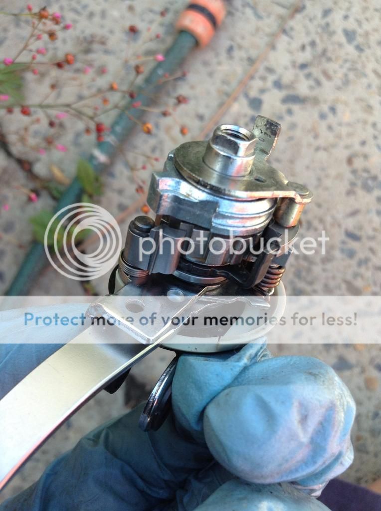

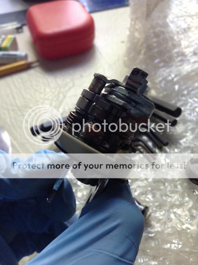

Very simple. The internal gears have been reached, and now you can ahead with cleaning it. I am using fuel, but you can use your degreaser, or whatever youd like.
Silly me forgot to take pics of when it was all clean. Oh well, you can find the pawls, and grease those areas up.

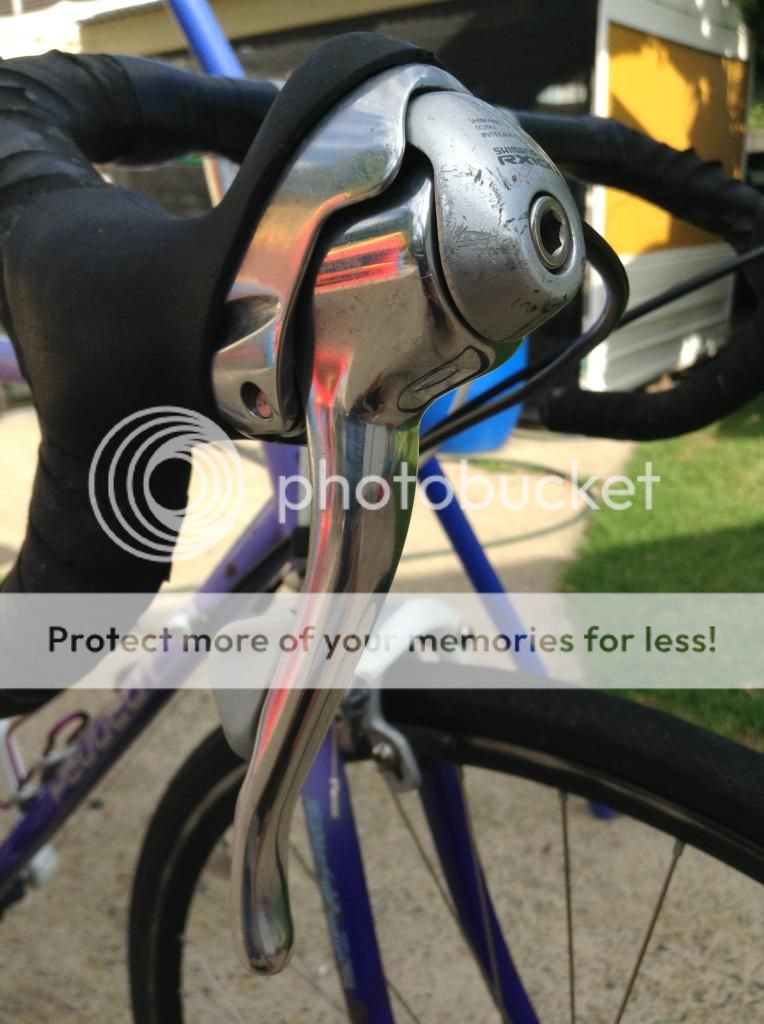

Now onto the left lever. As you can see its different in shape.

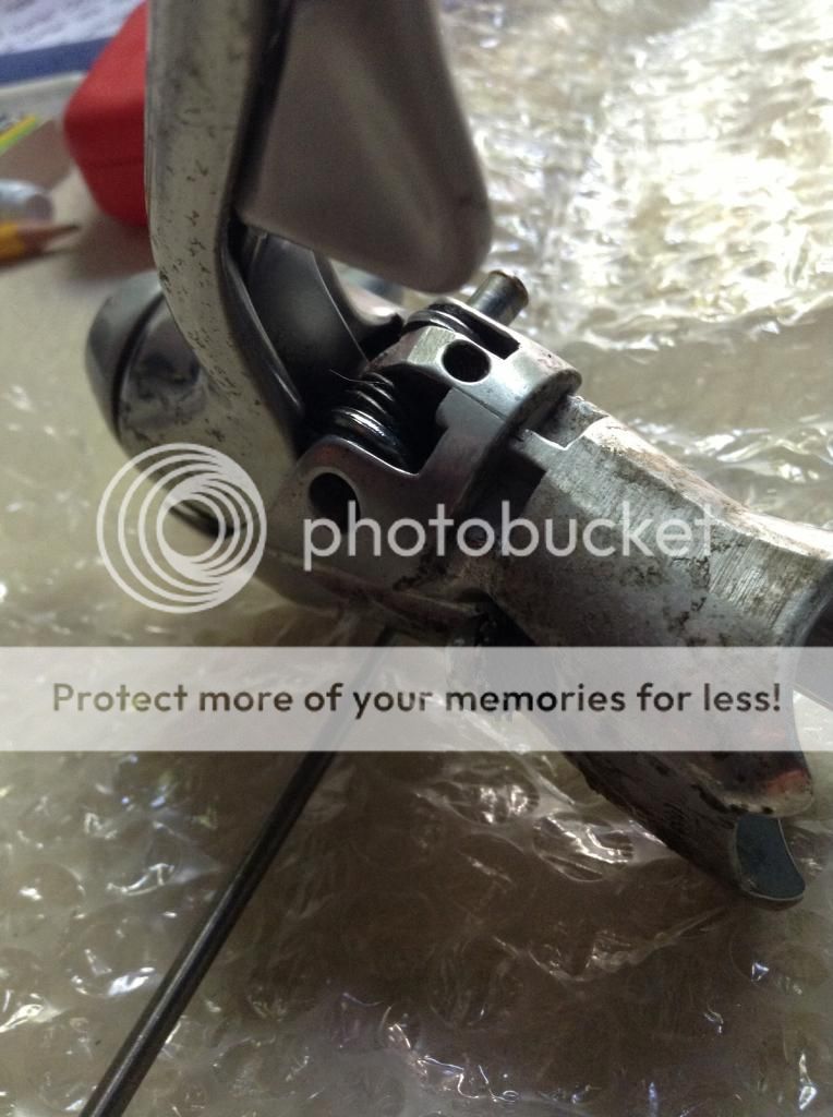

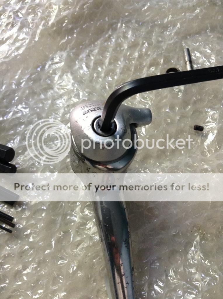

Next, use a 5mm hex key to remove the screw holding on the name plate. Make sure youre holding onto both the name plate and the lever when unscrewing. (Yes this is the pic of the right side, but its the same thing as the left)

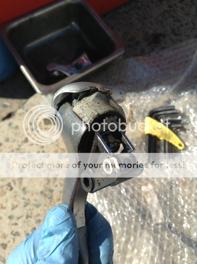

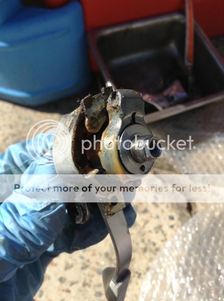

Its odd that the spring stayed like this when I pulled it off. It should be like the pic of the right side. Pulled it out, and noticed the spring that was supposed to be bent at a right angle was bent to almost straight again. Rebent to a right angle, and everything was fine again.
Gummy grease!
Now the left lever has a plastic cover which may get in the way of cleaning. Using a toothbrush, you'd get to most places, but there are places where you cannot get to. This is where I got my airbrush out and filled it up with some fuel. At max air pressure, I sprayed, and blocks of grease flew out. Keep repeating this til theres nothing else coming out.
You can go ahead and grease the pawls.
Final result after a polish of the levers. Would've liked to remove the rashes from the name plate, but preferred to keep the RX100 logo there.

The spring is Shimano part no 66E 7300 - pictured here in the write-up above:
I've picked up some rx-100 shifters - the left one works, but the right side is missing the spring and o-ring. The o-ring I can live without, but the spring is kind of important :)
