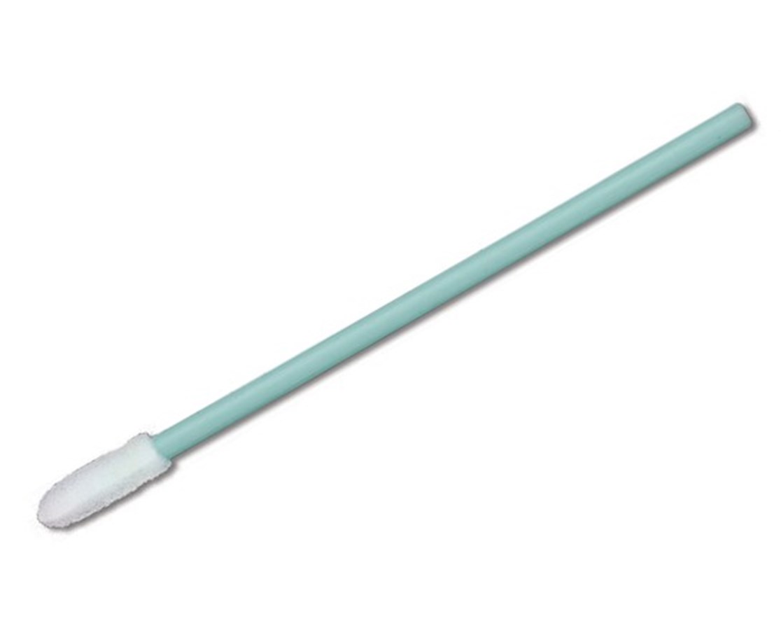

Qtips cotton buds often leave lint fibres.
Go past a cosmetics counter where they have testers... they use these short stubby "applicators" with heartshaped foam tip... acquire a handful, they're really great for dabbing paint into stonechips. ;)
For smaller pinholes I use a bamboo toothpick. Slightly larger hole to fill, get a bamboo takeaway chopstick and stick it into a pencil sharpener. Makes great tool for poking paint into odd places.

Tamiya wrote:Qtips cotton buds often leave lint fibres.
Good tip on the testers. Your right about buds, have had the odd fibre to deal with. One of those last minute or late night jobs before a cruise :wink:
If qtips are all you got... snip off the cotton blobs :twisted: I find the plastic or paper stick a better paint tool than the bud :P especially when you cut it at a sharp angle like a quill pen nib.
