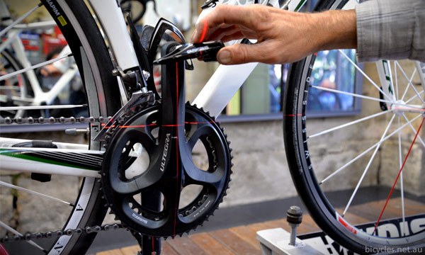

Bike Fit Shoe Setup
Bike Fitting Laser
The cleats are intended to allow you a way to place the shoe on the pedal in exactly the same way every time, and also helping the delivery of power in bumpy and unpredictable situations. The position of the cleat needs to be orientated to suit the skeleton of the foot. Fore and aft, side to side, and rotational adjustments can be made. The hip also needs be considered when positioning cleats as the alignment of the foot will have an effect on the hip and knee motion.
Cleats can also be wedged and shimmed to change the entire orientation of the foot on the pedal. This affects the kinetic chain above and can help increase stability when correctly set-up.
